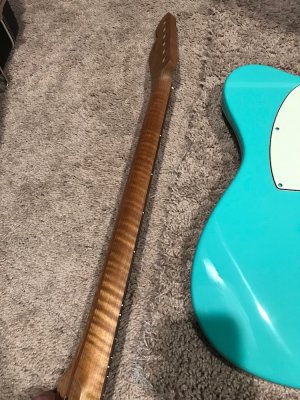

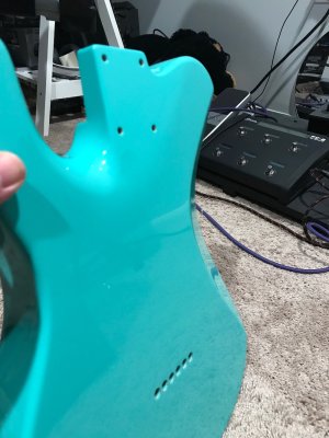

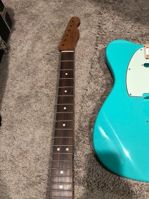

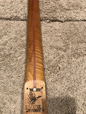

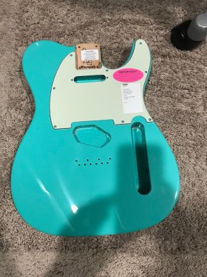

I now have everything together for my first partscaster (except the courage to start drilling and burnishing haha) :)
Neck specs:
Style: Telecaster®
Construction: Vintage/Modern Construction
Orientation: Right Handed
Neck Wood: Roasted Flame Maple
Fingerboard Wood: Pau Ferro
Nut Width: 1-5/8"
Back Shape: Standard thin
Fret Size: SS6105 (Stainless)
Tuner Ream: Schaller (25/64")
Radius: 10-16" Compound
Scale: 25-1/2"
Fret #: 22
Pre-Cut Installed String Nut: GraphTech White TUSQ XL - Standard Nut
Inlays: Cream Face Dots
Side Dots: White Side Dots
Finish: No Finish
Alder body in sea-foam green w/ comfort cuts.
Took me a TON of reading but I went with Cavalier Nashville/Lion King pickups. Also got a prewired Emerson 4-way switch.
Hipshot open gear locking tuners, gotoh "in-tune" bridge, mint green pickgaurd
and some pics :)
