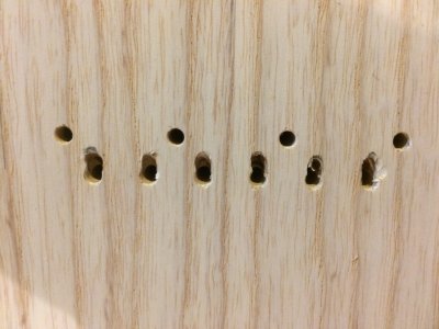

Asimple, (maybe cunning) plan. I don't like that the bridge, when aligned with the string-thru holes and HB rout, will give me just enough, maybe enough forward travel.  :sign13: I decided to enlarge the string-thru holes just enough toward the neck (1/8") to move the bridge by that much. This way, the humbucker will be happy, and I'll have enough forward travel to make me happy. There will be plenty of rearward travel, in fact about 1/2". I enlarged the holes with a Dremel tool and a small burr. The slots aint real purty, but they don't really have to be, being covered by the bridge  :)
Remember you have to feed those strings from the back of the guitar, so if the holes don't line up on top, you're unlikely to get the string through the bridge holes.
Don't know if the pic shows it very well, but yes, I "routed" those holes open at an angle to the original, if that makes sense, so as to allow the strings to come through. The Babicz bridge also has holes at the back of it so you can "top mount" the stings if you like. They say that's the way the Reverend Willy G. does it.....a haw haw haw haw:glasses10:
