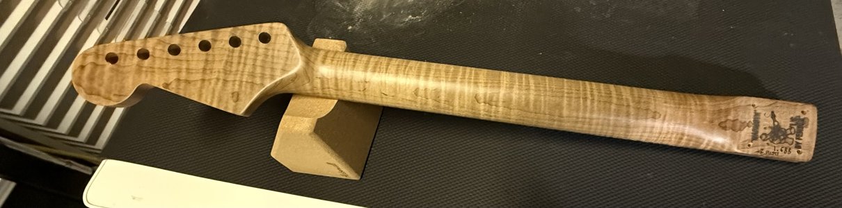

Fifteen weeks and the body is still “processing” (I really wish Warmoth would give more detailed status on where your order is in the process), so I decided to burnish the roasted maple neck - my goal is to get the same glassy smooth and hard feel as my Suhr with a roasted maple neck, which is my gold standard for how a neck should feel. After about an hour with the Super Bufflex and Super Assilex, it’s pretty much there:
I did the back side of the headstock as well, maybe not quite as rigorously as the neck, but I’m happy with it. Grit progression was 600-800-1000-1200-1500-2000, and the Super Assilex and Bufflex were awesome. Once this build is done, I’ll go back and do this to my 2023 build, which also has a roasted maple neck.
I did almost all of this going along the grain, not against as in Aaron’s video, except for a final pass with a super-soft microfiber towel, which I did across the grain.

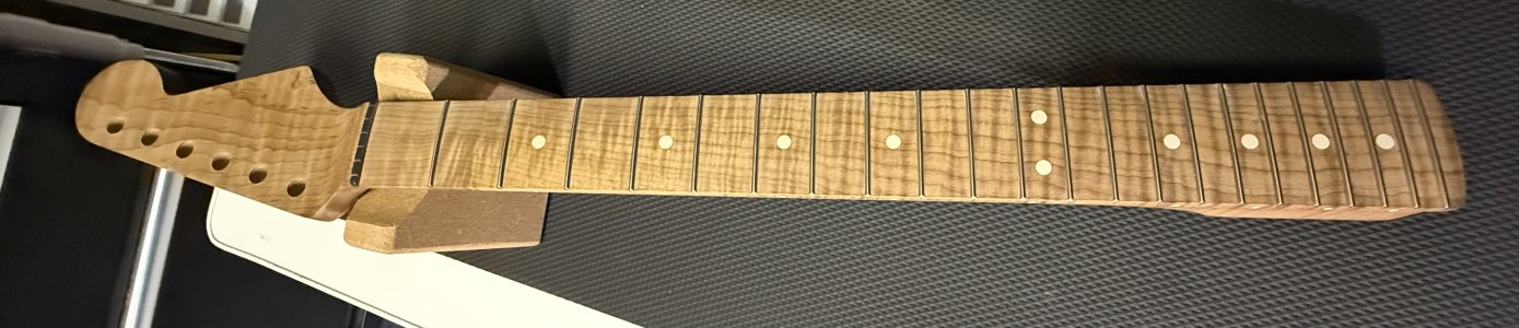

Oh, and here’s the front of the neck:

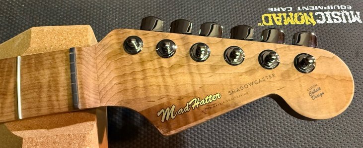

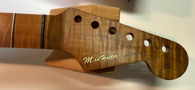

I just ordered a tool for drilling the pin holes for the Schaller M6 two-pin tuners, and today I will start in with some light coats of clear lacquer on the headstock as the base for my custom R&F headstock decal. And with a holiday weekend coming up, it would be a perfect time to finish this guitar, if Warmoth will get me the danged body! (Please?)
Looks great, great job on the burnishing. I went to 3000 with the Bufflex and it is wonderful. I’m debating a clear on the headstock as well. When I sprayed the naphtha on it to clean up after sanding it really popped the grain. Keep us posted.
Well, 16 weeks and nary a peep from Warmoth about the body; even if I got the shipping notice tomorrow, no way it gets here before the holiday so looks like this is going to be a June build. And I can’t install the tuners until I get a tool (from StewMac) to precisely drill the retaining pinholes for the Schaller M6 two-pin tuning machines. So…I’ve been installing the headstock decal:
Had the decal made by Rothco & Frost; pretty decent quality (and super-thin). It’s got a couple of annoying flaws in the metallic ink, but nobody will notice it once it’s on the strung guitar. I masked off everything but the decal area, laid down about half a dozen coats of gloss lacquer, let it dry for 24 hours, then sanded the lacquer flat with 600 grit Super Assilex. Cleaned it all up with mineral spirits, let that dry, then installed the decal, not too difficult - maybe my boyhood days building Revell and Monogram model cars and planes are still in the old synapses. Anyway once positioned and blotted and dried for another 24 hours, I did four mist coats on 30 minute intervals, let dry overnight, then about three thin normal coats. Another overnight dry, then pull the masking tape, gently sand flat with the 600 again, then with 1000 for good measure, then a mineral spirits wipe down.
If you look closely you can see the line between the lacquered surface and the bare wood. I kind of tried to feather that edge but in some kinds of light you’ll always be able to see it. I ain’t sweating it; if it annoys me too much, I’ll sand it off, but I think it will be fine; again nobody will really notice with the guitar strung up.

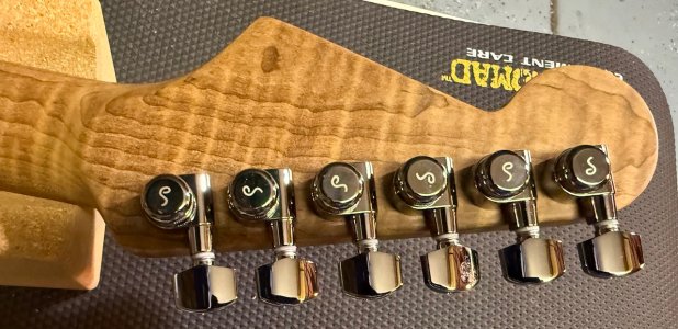

What about some in progress photos of the holes drilled, and the tools used to do it?
I didn’t take any pictures of drilling the holes for the Schaller locating pins :confused: but the process was straightforward: I put masking tape on the back of the headstock alongside the tuner holes, then inserted the tuners into the headstock, used a straightedge to get them aligned, and carefully pressed them down hard enough for the locating pins to make indentations in the masking tape (the locating pins on the Schaller M6 tuners are pointed). I then used a tuner pin drill jig from StewMac as the guide to drill the holes; the only tricky part was aligning the drill jig with the locating pin indentations, but some magnifying glasses and a flashlight made that not too hard. I used the jig because I don’t have a drill press.
Here’s a link to the drill jig:

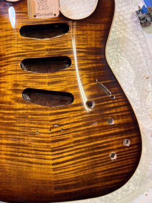

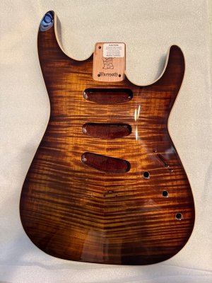

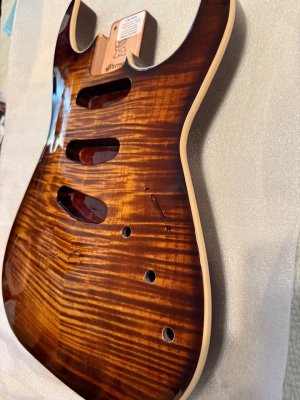

The body has arrived!
The ivoroid binding is darker than I thought it would be; looks almost identical to the cream binding on my Warmoth Tele from 2023. But that’s barely even a nit; the binding is great. Very happy with the tobacco burst-over on the back of the alder body. And the tiger’s eye dye on the unique choice lam top looks even better than I thought it would. A beautiful guitar body!
I did the basic measurements with the neck in place but not screwed in, everything good. I also made sure the pickups fit - that was an issue on my Tele, but these pickup cavities are huge by comparison. That’s all I have time for tonight; tomorrow after work, I think my first order of business is to check fit the controls (although visual inspection says that the short-shaft controls will fit just fine), then locate and drill the additional hole I need for the clean boost control. I think I will locate it so as to make a near-equilateral triangle with the master tone (middle hole) and mid-boost control (the hole closest to the output jack). Drilling that hole will be the most ticklish part of this build; I’m thinking about getting a stepped bit for it, but maybe drilling one pilot hole then drilling the final diameter would be ok too. The shaft of the clean boost control is 8mm diameter (about 5/32”), so not huge but not small either. Chipping of the finish is what I really worry about. Decisions, decisions…
Edited to add: delivery was seventeen weeks less one day from the day I ordered this body…
Looks great ! The burst over is very well done. Good luck with drilling that hole, that’s always a little nerve racking on finished bodies.
It's beautiful. I like it a lot, but your pics are different to what I would have expected from Tiger's eye (not very much yellow).
I think the binding looks like cream. I wouldn't complain if it was me, because it has come out very well.

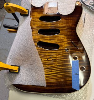

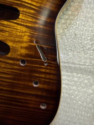

Got some work done last night…first up was the switch channel:
Three issues: first, it hadn’t been chased out after the body was finished, so it was too narrow. Second, maybe it’s the same length as it would be in a Strat pickguard, but with a quarter-inch thick top in between the switch body and the switch lever, the channel wasn’t long enough for a standard Strat-type 5-way switch to have full travel. Third, it’s not properly lined up between the screw holes. To fix all of these issues, I had to lengthen and widen the channel:
Not the prettiest work I’ve ever done, but it won’t be noticeable when the actual switch is installed.

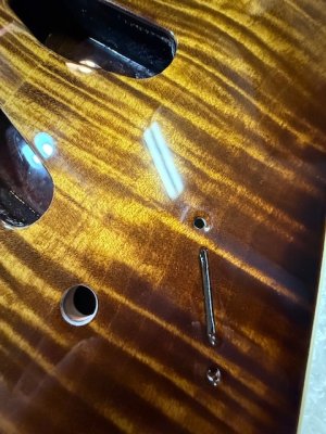

Next up was what I knew would be the most ticklish part of the whole build - drilling the new 3/8” hole for the onboard clean boost control. I’m not a woodworker, so I poked around on teh intertoobs, and the best suggestions I found were to put tape over the area where the new hole would be drilled, drill a starter hole first, then drill the full-sized hole with a brad tip drill. Before, with the new hole location marked:
And after, with the new hole drilled:
The clear gloss chipped a bit despite the tape, but not much, and it will not be noticeable once the actual control is installed. There’s also a bit of blowout on the back side but it’s not enough to affect installing the control, and it’s in the electronics cavity of course. (I wonder how Warmoth drills these holes; they clearly were drilled after the gloss finish was applied…)
