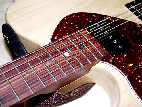

:icon_scratch: Just got my new tele body in. I will post pics soon.  Its a rear rout with just a bridge pick-up. The neck sits  higher than the body in the pocket. Is it supposed to be that way? If it is I don't mind, I just don't want to have the wrong neck. When I bought the neck from the showcase it said Tele...

That's normal. When you look at the neck join area you should see almost as much neck wood as fingerboard wood above the top of the body.

the joint and neck are to the vintage fender specs. that keeps it all compatible. nofmally fenders have a pickguard which fills the gap perfectly. the gap is entirely normal and you'll need to live with it unless you can find someone you really trust to route the pocket deaper, note that doing this means a slight angle in the pocket 1-1.5 deg. i did this to my tele with a jig i made. i don't know the precise angle off the top of my head as i used the taper per inch method to make the angle which works out like this .125/7.125= aprox .0175 per inch that is 17.5 thousandths or 52.5 thou over the length of the neck joint, quite small but very important.

Alder body with quilt maple top dyed red. birdseye maple neck with ablone dots.

AAAAAAAAAAAWWWWWWWWWWWWW  YEEEEAAAAAAAAHHHH
Look at the bookmatching on that quilt.  Great stuff.
Pics of it fully finished please ! ! ! !

Willyk that figure in the fretboard is awesome.
newtele that tele looks good, or rather just plain bitchen awesome

Thats really nice mate.
What pickup did you go for?
I love the bookmatched quilt maple.  and great colour choice too.
