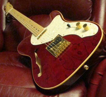

I've taken a greater liking to a new finish idea. I dark red transparent, Like a Wine Red. Something like this.
Obviously it won't be that gorgeous but I have seen the color on some other gold hardware telecasters and It looked great.

I love that color scheme.  Perhaps you and your father might want to try natural masked (fake) binding.
