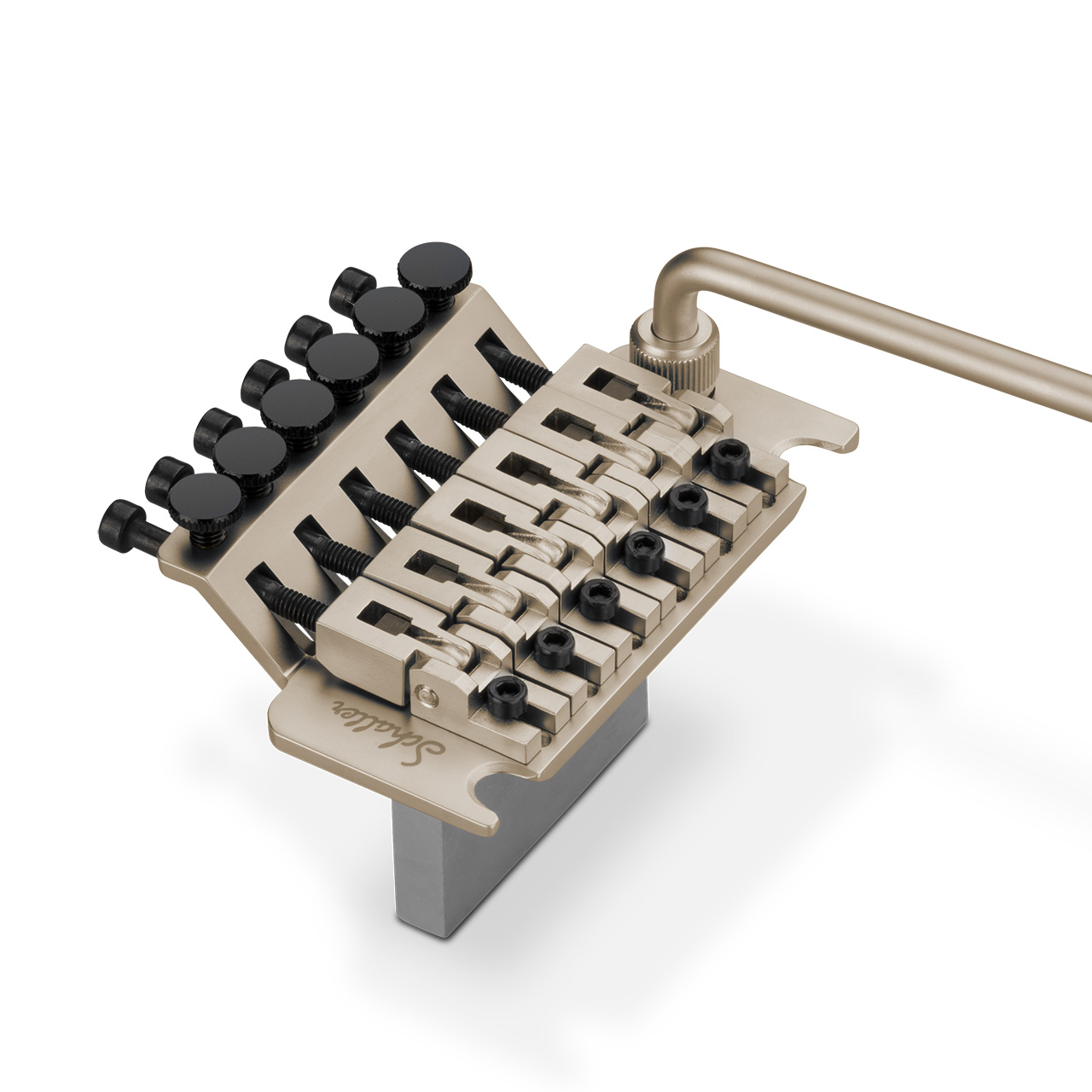

  • Is a neck compound 12-16” radius OK, if I choose an R3 nut (10”) and the Schaller Lockmeister bridge with no shims (16”)? I have only read on forums about these radiuses (nut and bridge), so I am no sure?
  • Is the Schaller Lockmeister exactly the same thing as the Original Floyd Rose?
The difference is slight between a 10" and 12" radius.
At the bridge you need about an 18" radius so you would need to remove the supplied shim and add some shims.
For a 16" radius at the bridge a more optimum compound radius is 10 - 14" but Warmoth does not offer that. On balance 10 - 16" is close enough but you will need to shim to 18" at the bridge.
It is the same dimensionally but has improvements from the point of view of Schaller over the OFR (which Schaller makes for Floyd Rose). Depending on where you live the Lockmeister is probably a better value in terms of price. Note the link below is for a Left handed Lockmeister, the right handed ones do not appear on the Schaller site any more at the time of writing. (you would also need the 37mm block option)
