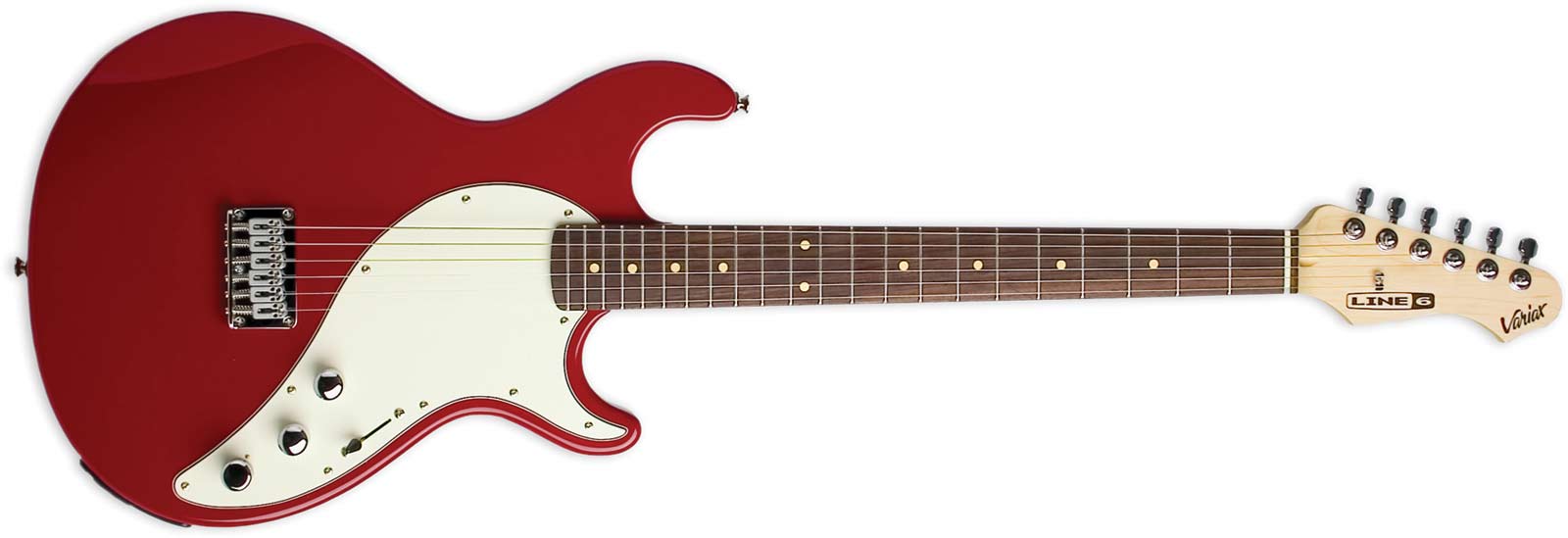

Okay, for those of you not familiar with the Variax, here's what it looked like originally:
Pretty much a very, very cool piece of technology trapped in a very cheap looking, Asian-made plastic coated, soulless hunk of cheap wood.
