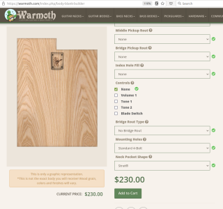

Voila - 7/8 body blank. Also 55/64th body blank and 29/32ndths body blank.
swarfrat said:
Yes. Nothing but the neck pocket
Eeeesh, I'd be very leary of routing for a trem this way.
But, you're making me think.....
I wonder, if one did get a normal blank with a neck pocket and bridge route, and then lengthened the channel for the neck pocket...I wonder if that would be the way to go.  I'm guessing the dimensional difference would be a neck pocket?  I'm guessing brining in the pocket by 3/8" would correctly align the distance from the bridge to the 12th fret and nut for the correct intonation?
Sorry - sometimes I forget that post 1989, virtually 99.99% of electric guitars STILL come with tremolo systems.  I was thinking "just measure, mark and drill" for the bridge.
