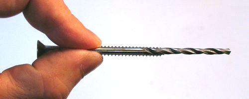

You can go by charts, which usually work out fairly well. They've been developed through long experience. Or, you can sorta sight it in by holding the screw behind the bit with a light source behind it.
It's sloppy, but works in a pinch. If you can't see the threads, the bit's too big. If you can see the shaft, the bit's too small.
