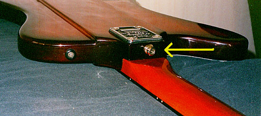

Get a Mahogany body, light tuners on the neck and put the strap buttons like this:
Problem solved, I think
whyachi said:
I can do that. I'm not incredibly worried about the total weight of the guitar, just the balance.
Glad you said this, because a maple Thunderbird body will weigh some. Q: Would a Rosewood body be heavier in weight than maple?
OzziePete said:
I think rosewood is heavier than everything, but I don't have $700+ for the body wood. I was intending to use Ultralites from the beginning - I've played Thunderbirds before.
