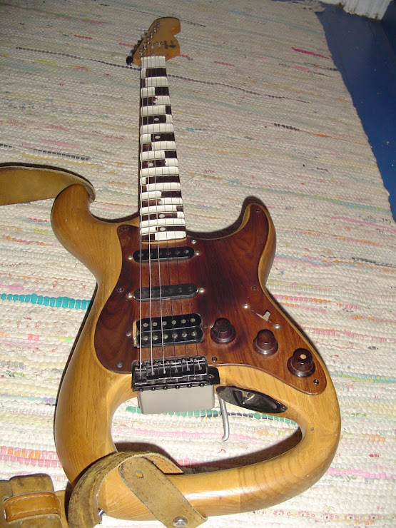

Equally as radical is  Finn Schatvet-Riisager's lightening mod: (His fretboard extension is also pretty radical - I swear I saw some older pics where he had mounted a rosewood two string 1 fret extension behind the nut, but his approach is much simpler. Only the 1st and 2nd strings pass over the nut. 4-6 are actually "zero-fretted" at the 1st fret. So he gets open strings in P4 tuning. I also like his jack placement :)
I've seen this guy's guitar a few times since I've been playing P4 tuning for a while - and it's plastered all over 30% of the internet resources on P4 tuning. Recently he posted this video, and I thought "Doh! I bet these guys are known as "the band with the guitar player with the piano fingerboard".
