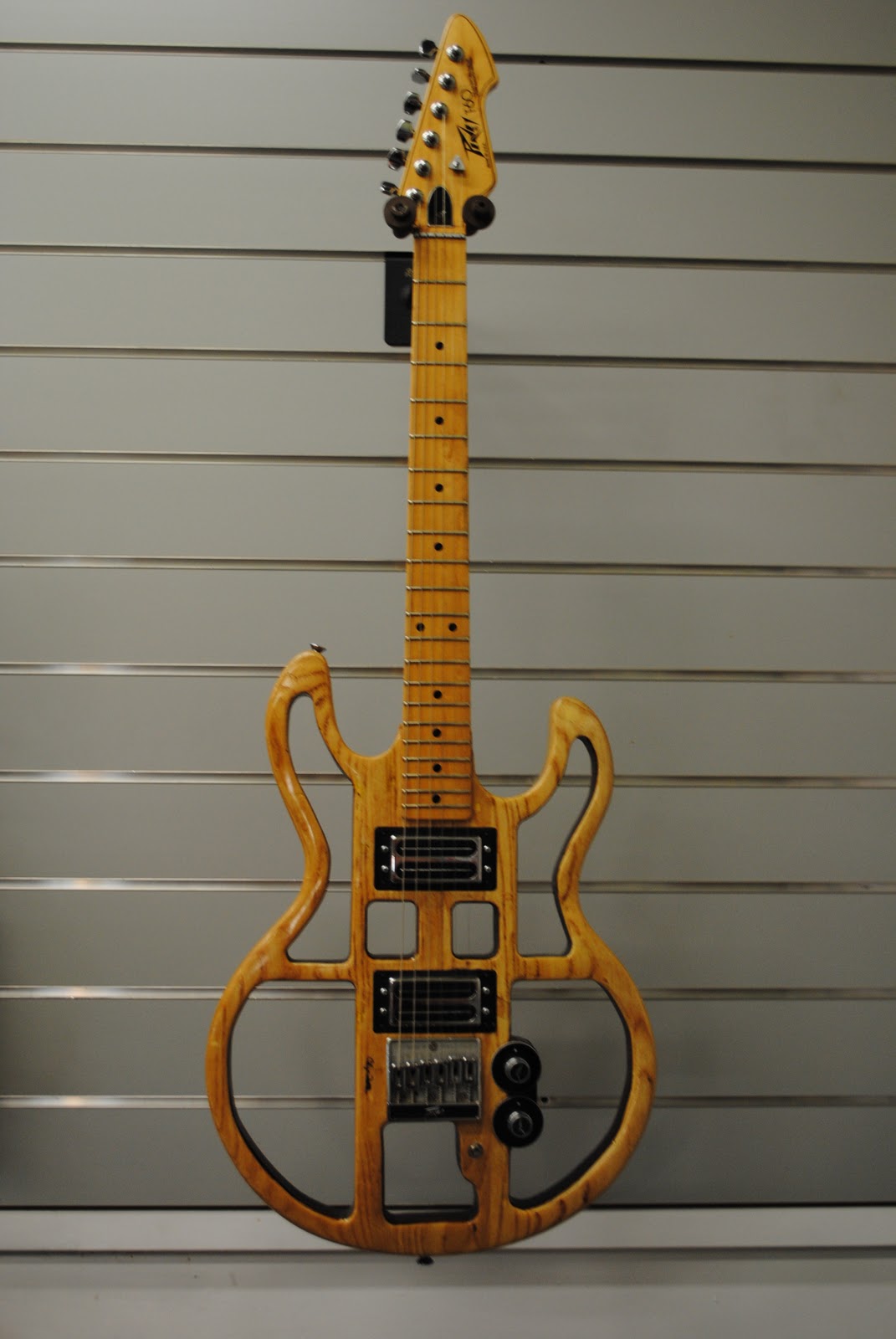

You know, I had a Peavey T60 in the 80's and I did some hole-cutting and sawed a Musiclander-type notch in it. Got it down to around 10 lbs. maybe, apparently nobody told Mr. Peavey about the "swamp" part of ash.... and put my very first "part" on it, a giant no-name maple/maple replacement neck I got at Guitar Resurrection in Austin for $99. 13 lb. guitars with popsicle-stick necks, we all gotta start somewhere. And then after I made it useful - really useful - I traded it for my first pedal steel, a S10 ShoBud, which if I still had it would have turned out to be, like, my 3rd-best deal of a lifetime. Do NOT ask about the 2nd & 1st, if I still had 'em..... :sad1: :tard:  :sad:
