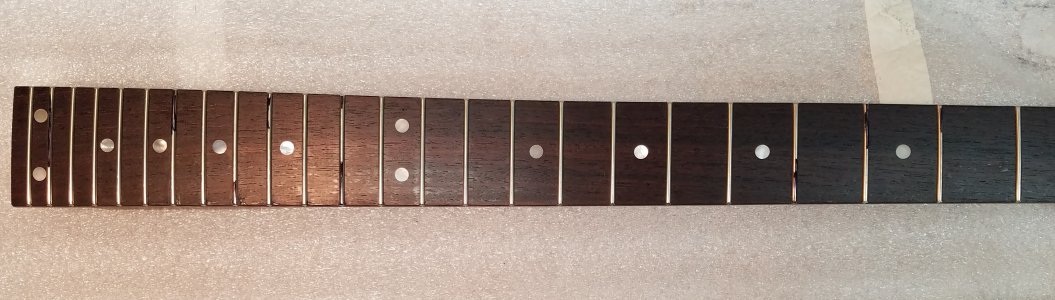

I don't know what the easiest way to go about this is. It does seem like the high spots are all over the place, so I'm not sure I want to use a long bar and sand them all back.
Then again, I don't want to mess with this for hours and hours doing each one individually if there's a faster method.
Suggestions? (see pic. High spots marked with black.

Frets should be level in relation to the opposing frets. As such, it's best to level them all and be done with it. Leveling individual frets might be ok for 1-2 high spots, but attempting to level 8 means you'll be chasing variances up and down the neck. You will end up spending more time.
The other alternative is you bolt it on, maybe adjust the neck and action a bit outside your normal specs, and play it.
I agree, use the long bar and level until you just barely kiss the tops of the good ones. They all have to be the same height.
Well, I now have about 20 frets with flat tops on them. The long bar took off a lot more than I thought it would and even though the neck looks flat, it wasn't getting the marks off that quickly on some of the high frets. Possibly the 1st fret was too high.
So now I have a about 20 frets I need to recrown. Which I'm not thrilled about. Part of me wonders if I should have done each one individually, but with that many bad frets, and the first now appearing to have been way too high, it may have been the only route to go.
