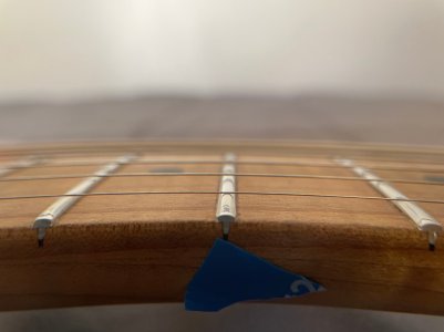

Can you take a good pic of the fret to see whether it's too flat on top? I'm not sure recrowning is a good idea unless you can do it without removing anything from the top, otherwise you'll run the risk of leaving this entire fret too low.
I'm guessing that you might be pushing the limits of how low the action can get for the combination of relief, string gauge, fretting + picking style, etc. Is the action comparable to what you've had on the high E on other guitars?
@ruscio Attached are a couple photos I was able to capture- second one viewed through a magnifying glass. (It's actually the 8th fret, not the 9th as I'd said.)
I feel like The beveled end of the fret looks a bit wonky and asymmetrical, but not sure. In the second photo I feel like I am seeing a pretty flat surface on the top of that fret. I've been having trouble eyeballing the shape on the shiny metal surface.
Action I'm going for is comparable to other guitars. Shooting for around 5/64 on low E and 4/64 on high E or thereabouts.

Thanks, it is hard to see in a photo, probably in person, too. That might be a bit flat, so maybe you're right that it needs a little more crowning. Can you tell how this fret's shape/curvature compares to others that aren't buzzing, whether the same string at other frets or other strings at this fret?
@ruscio Yeah having so much trouble telling visually, so hard to say. I do seem to be getting some of the same buzz on the 8th fret on the B string, one string over, but not as bad. I have a few other random spots here and there that are a little buzzy, but more within the realm of reason.
I may try to just recrown and polish this one fret under the theory that carefully filing with the z-file shouldn't lower the height of the peak of the crown. Just trying to make it skinnier/rounder.
Also tempting to redo the whole thing. If it's too flat here, I think it's probably borderline everywhere. In that case, I think I would do a couple quick passes with the leveling beam to ensure everything is super even (not removing much of any material), carefully crown down to skinny lines, and then be a bit more careful when using sandpaper to remove scratches before polishing with micromesh. Not excited about that prospect as this took me a long while to begin with, but it's all a part of the learning experience I guess.

The land is too wide. (the land is what should be the narrow strip leftover showing after crowning) use a felt marker (sharpie) so you can see your progress when crowning, which I think you mentioned doing.
The Z file is a good file and should be able to get you there.
Are your frets stainless or nickel and what size were they originally, such as 61xx...? They seem as if a lot of material (probably more than needed) was taken away during levelling.
I never use for crowning 150 grit on Stainless steel, as I prefer finer toothed files. 150 doesn't cut as smooth and it is just more work in the end to take out the scratches.

@stratamania I appreciate the reply! I also think the land is too wide the more I think about this.

This sounds like a good plan at this point. Even if you do chalk this one up to a learning experience, there's no harm in trying to recrown these frets. As @stratamania said, the key is to use a Sharpie and crown each fret until you have a very thin strip of marker left in the center. As you intend, I wouldn't use anything rougher than 300 grit, as that'll already require plenty of work to remove the scratches during the polishing process. (Ditto for the sandpaper on a leveling beam, though it sounds like you won't need to re-level and this is moot for now.) Good luck with the continued learning process, and if all goes well maybe this neck ends up in better condition than you think!
Yes, it is worth seeing if the crown can be made better. It also could be used as a neck to have a go at replacing the frets at some point in the future if it is something you wanted to try.

@stratamania @ruscio Just wanted to say thanks again for the help here! I was able to get to a much better result.
Ultimately the issue wasn't quite what I thought it was- I realized I had been using WAY too much force with the z-file, and I had actually screwed up the crown, especially toward the edge of the fret. The land wasn't a good thin, straight line across the whole fret crown, but was almost football shaped, tapering down to almost nothing approaching the treble edge of the fret. I guess I somehow missed it last time around despite checking with a fret rocker, because the buzzy fret was indeed slightly lower than adjacent frets under the high E string, but not on other parts of the fret. It also didn't have a clean takeoff point because I'd kind of obliterated the land instead of just making it nice and skinny.
I re-leveled the frets (not removing much material this time) and then re-crowned and polished up. This time I basically just let the z-file do the work, and oh my god it was so much easier and more comfortable. Lesson learned!
Also I don't think my fret height measurements (using the StewMac calipers) were quite accurate, so I hadn't taken quite as much material off the frets as I'd originally thought. I think I'm actually sitting somewhere close to 0.040" after all the above work.
That was a bit of a frustrating process, but I'm feeling a lot more confident now and was able to address the issues I had with my first attempt.
