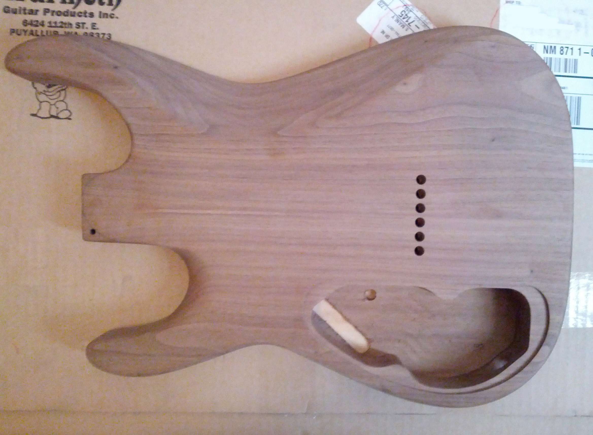

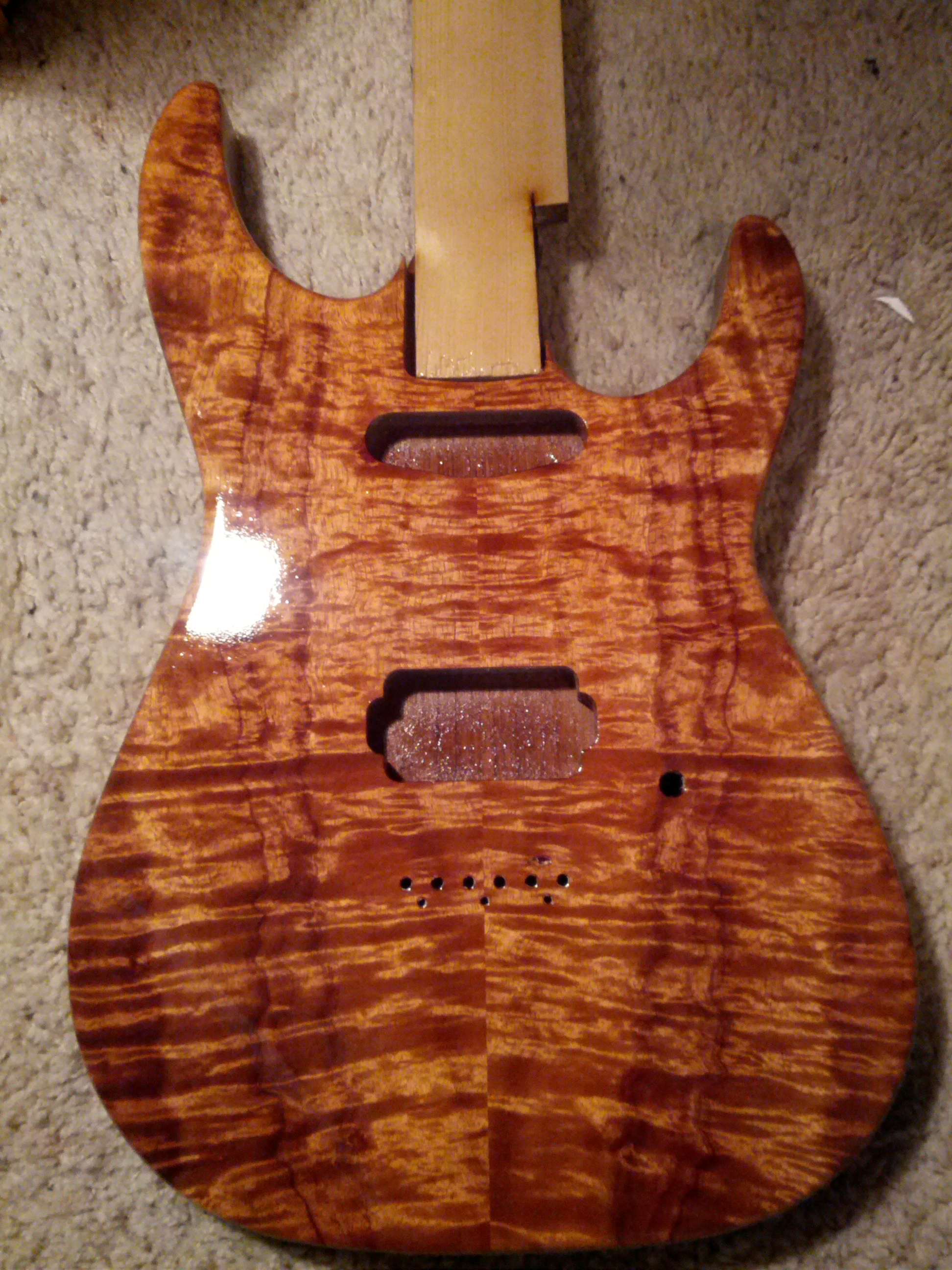

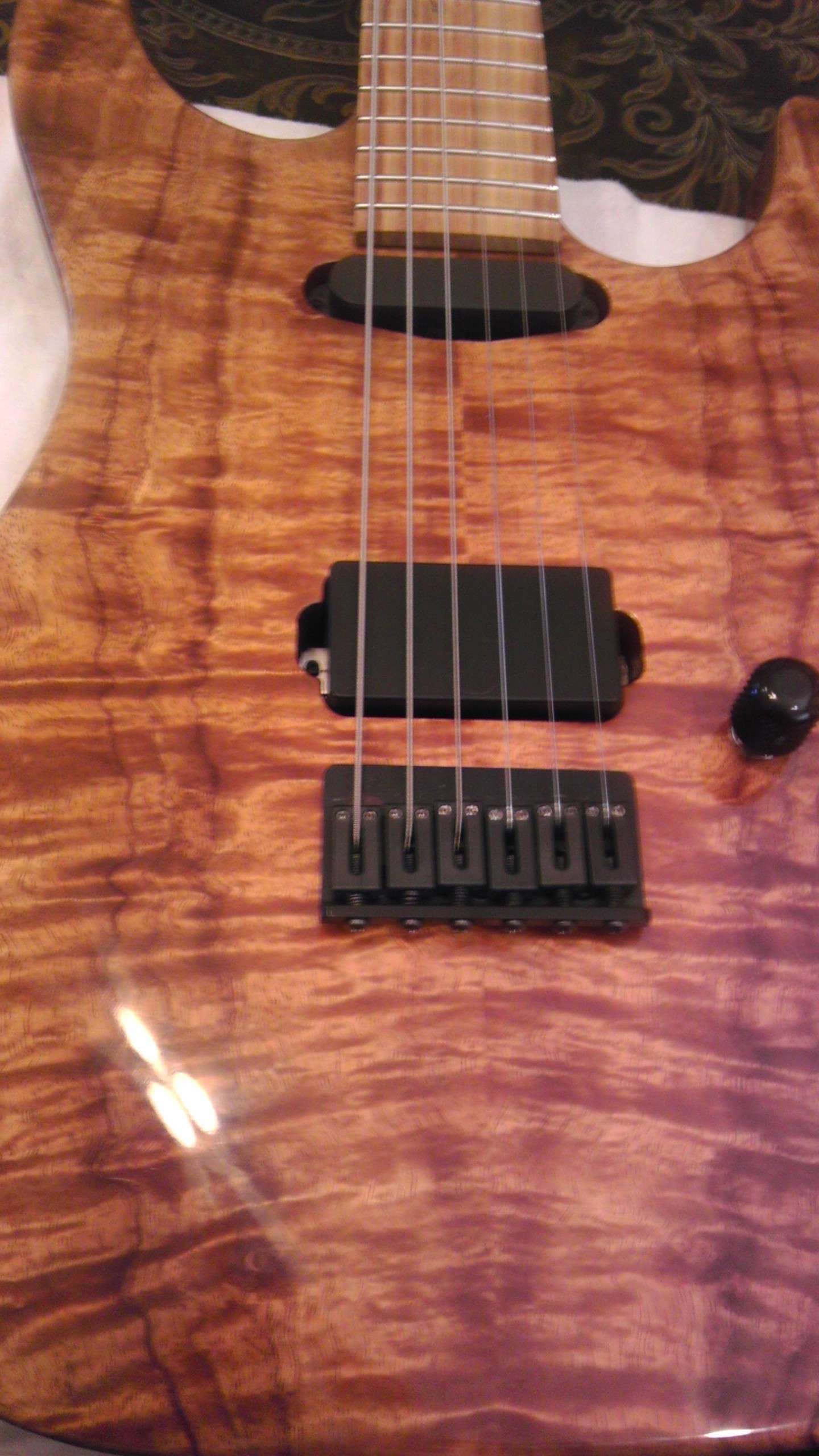

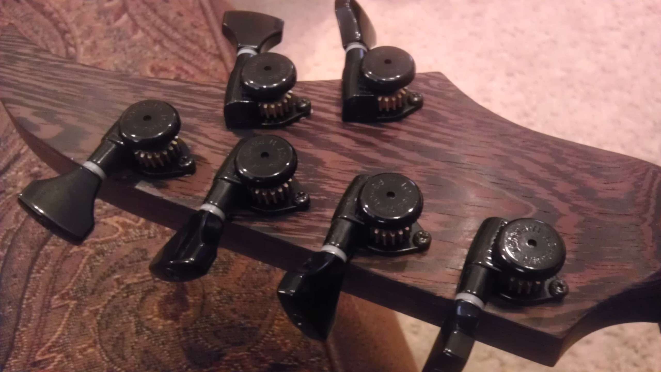

Ok So I'm starting with this:
Not bad right?

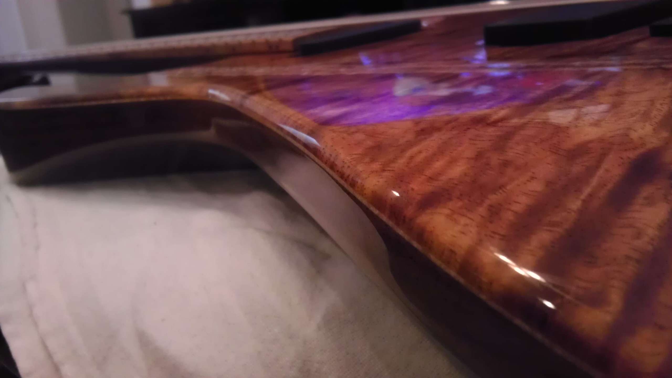

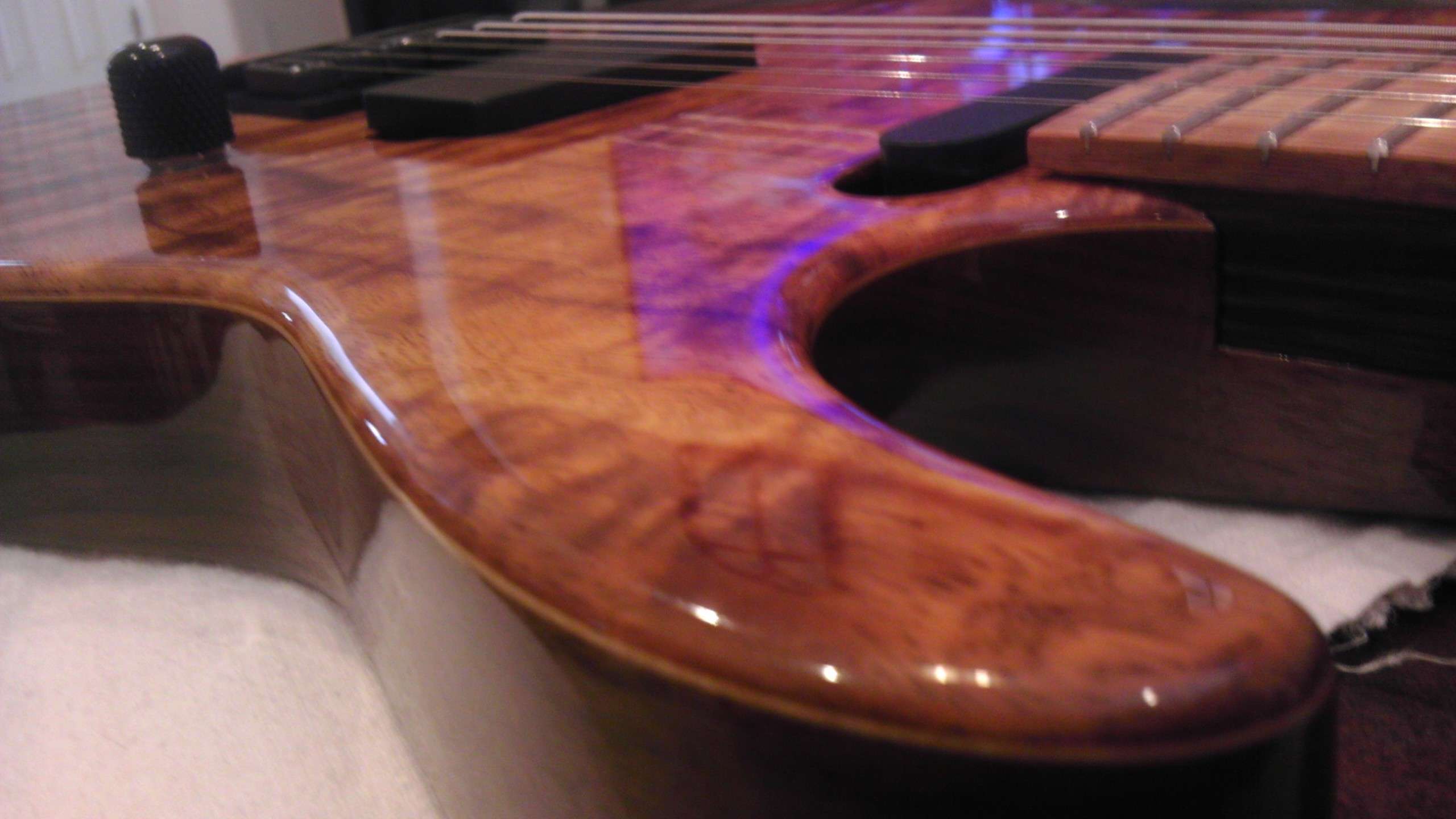

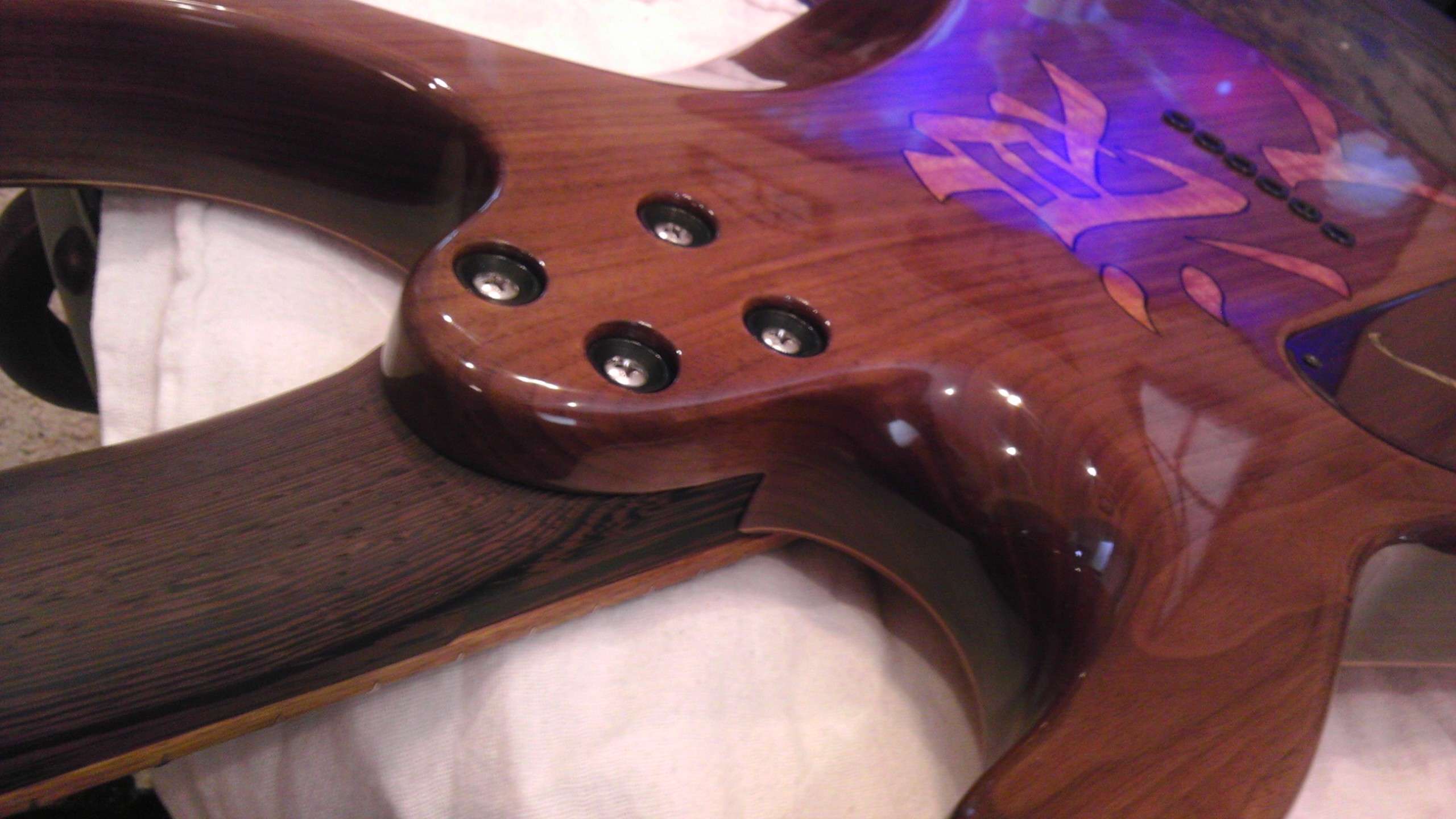

I decided there is not enough flamed koa on this beauty.

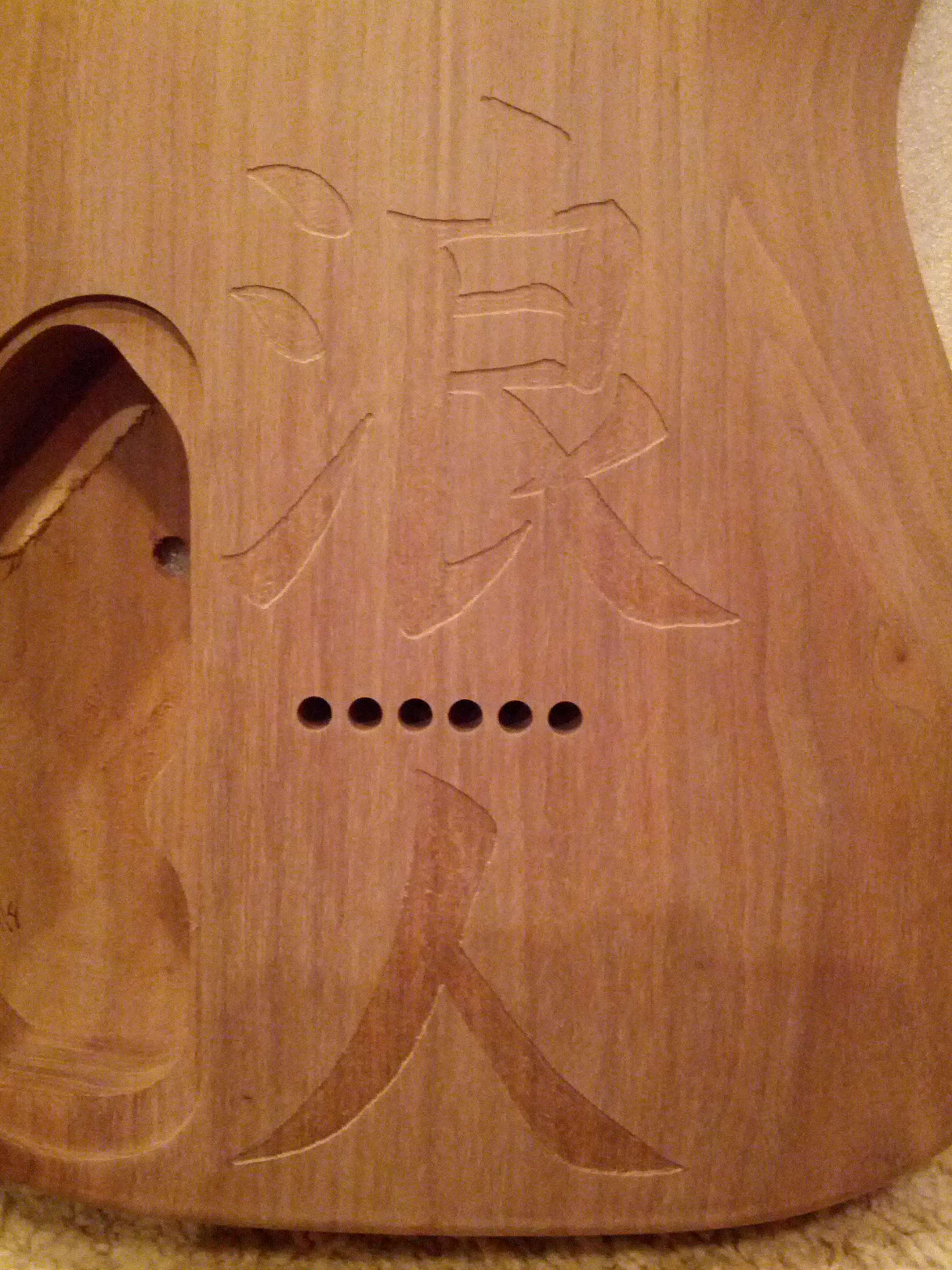

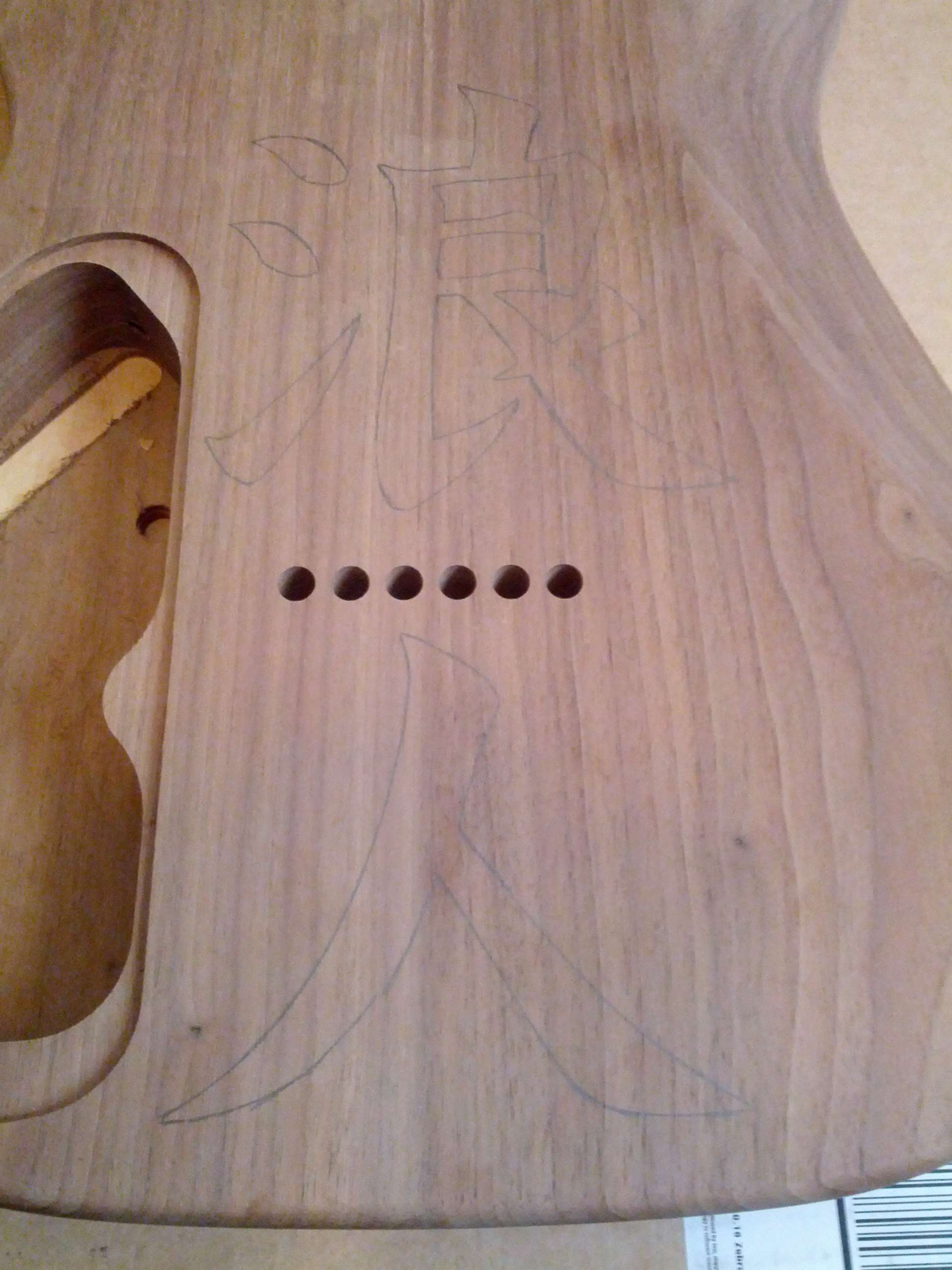

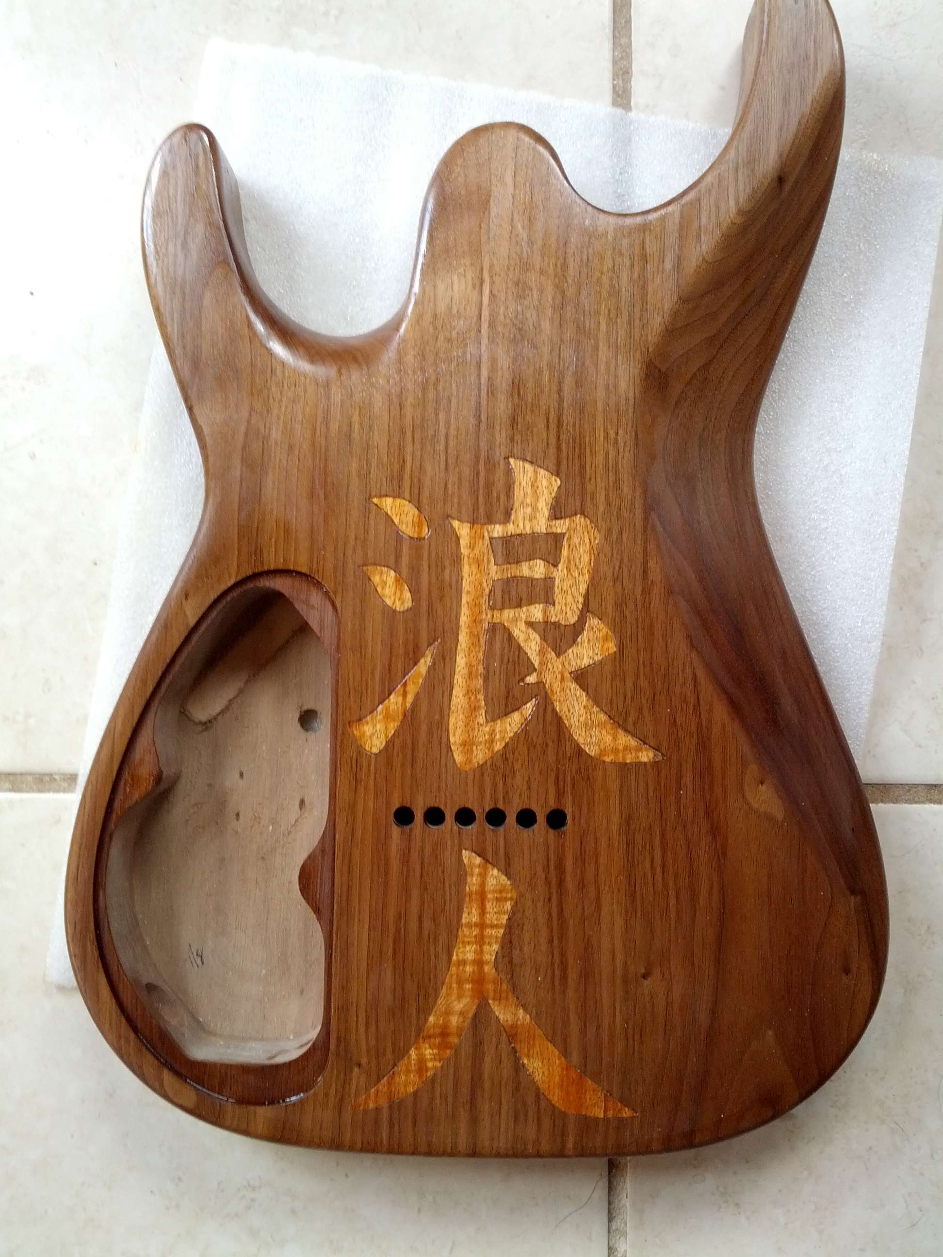

So were going to inlay some more in the back. Penciled out where I want it first.
Routed with a dremel.

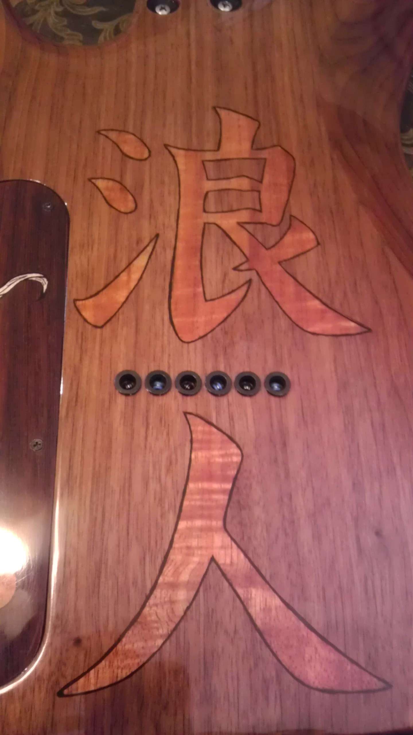

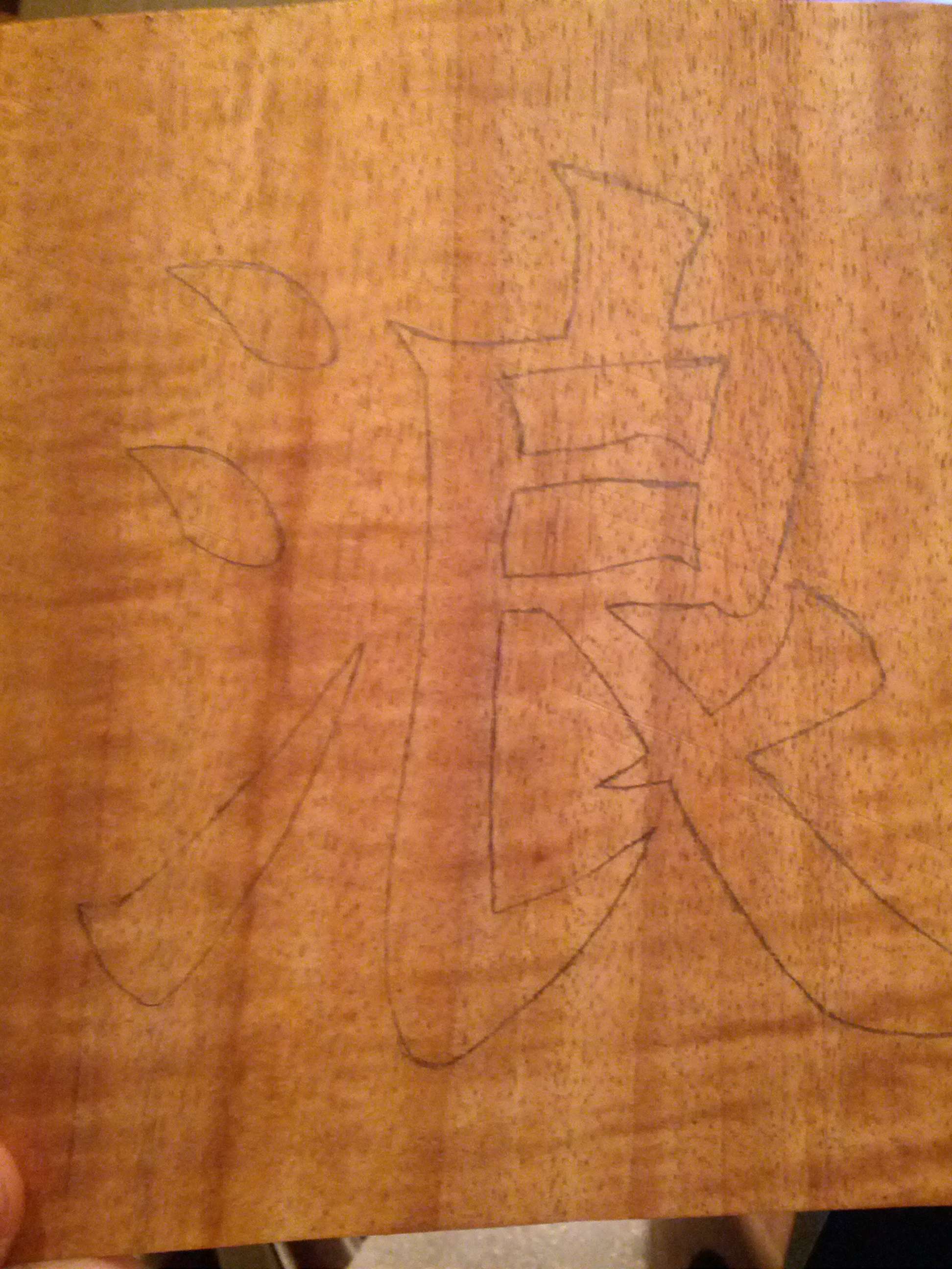

Penciled my characters on a veneer of koa 2mm thick and cut it out very carefully..

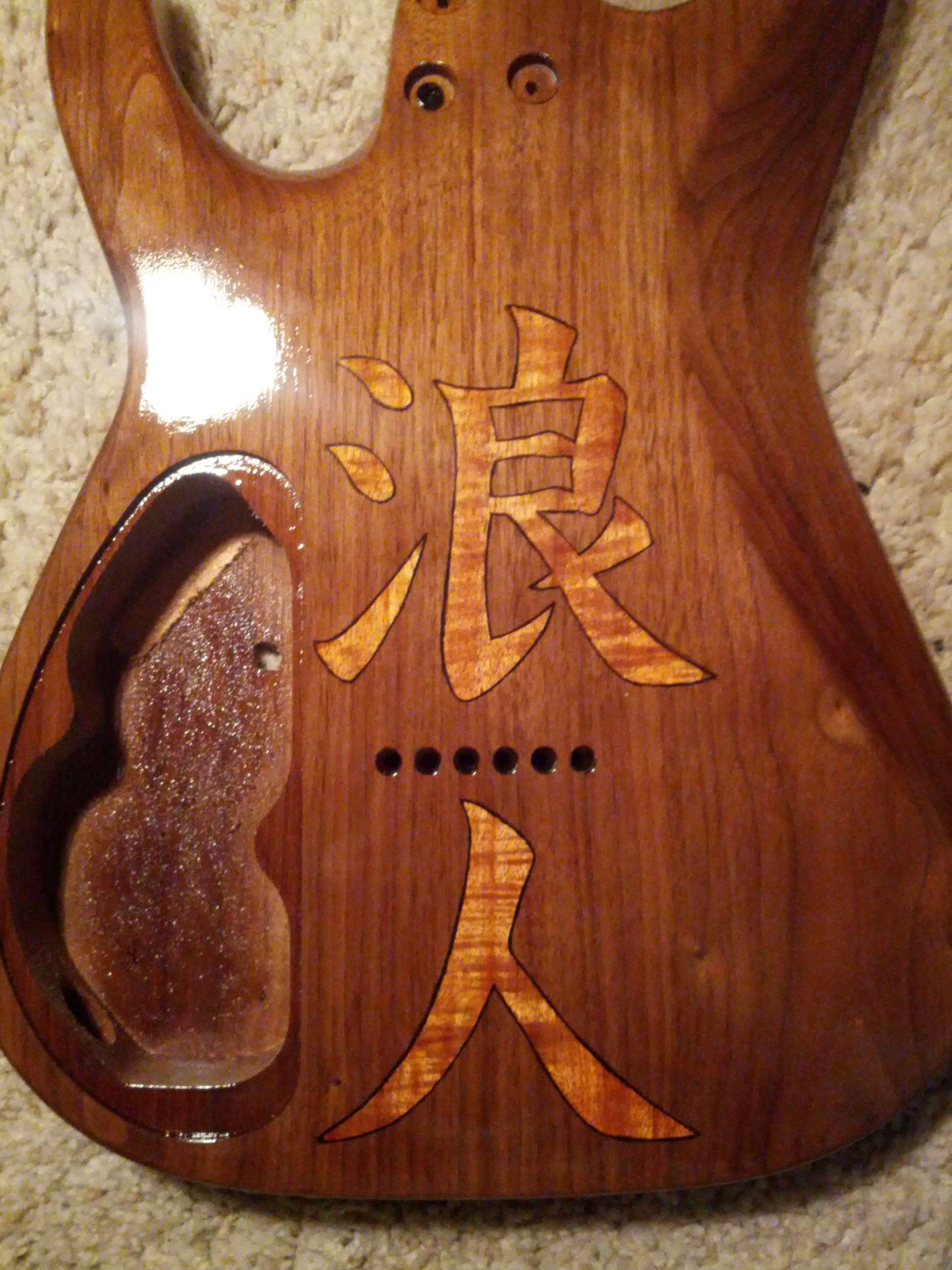

I glued the pieces in and let it dry overnight. Sanded the surface flat and level.
Here it is wet.

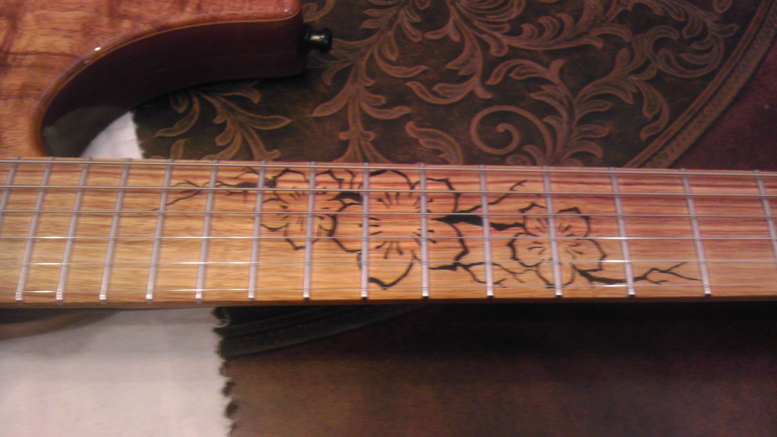

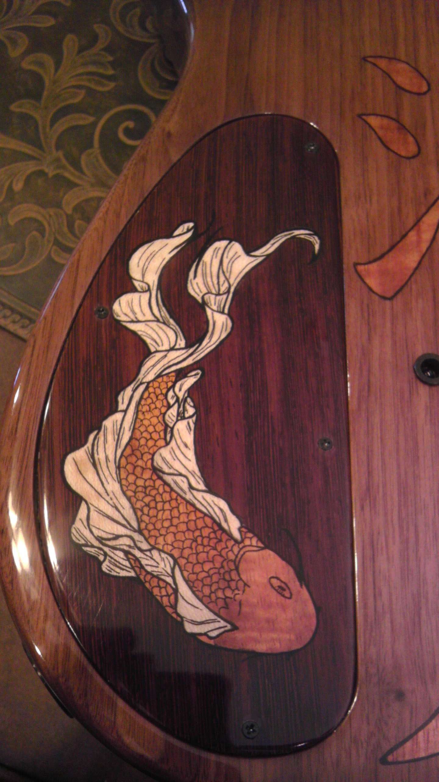

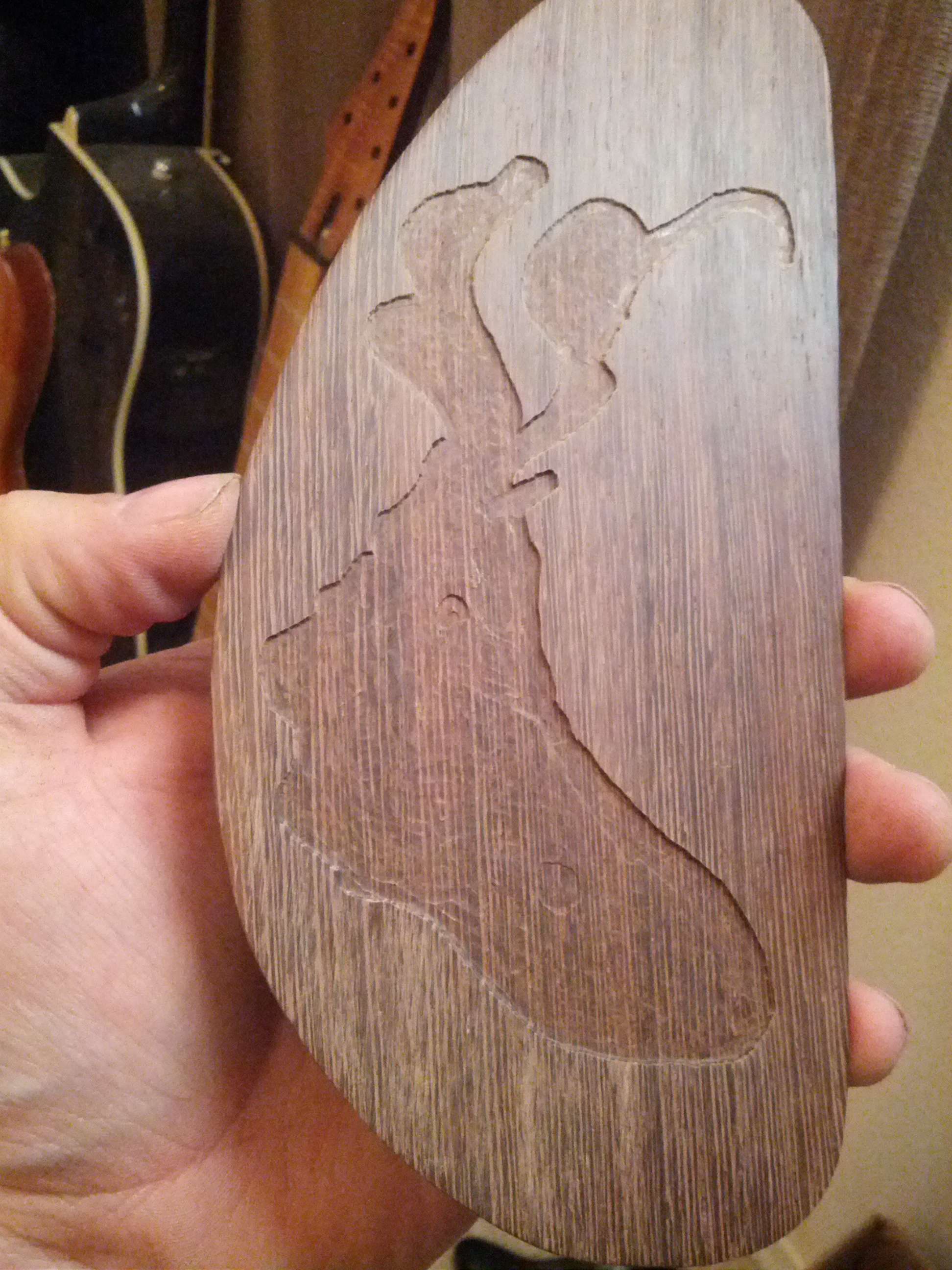

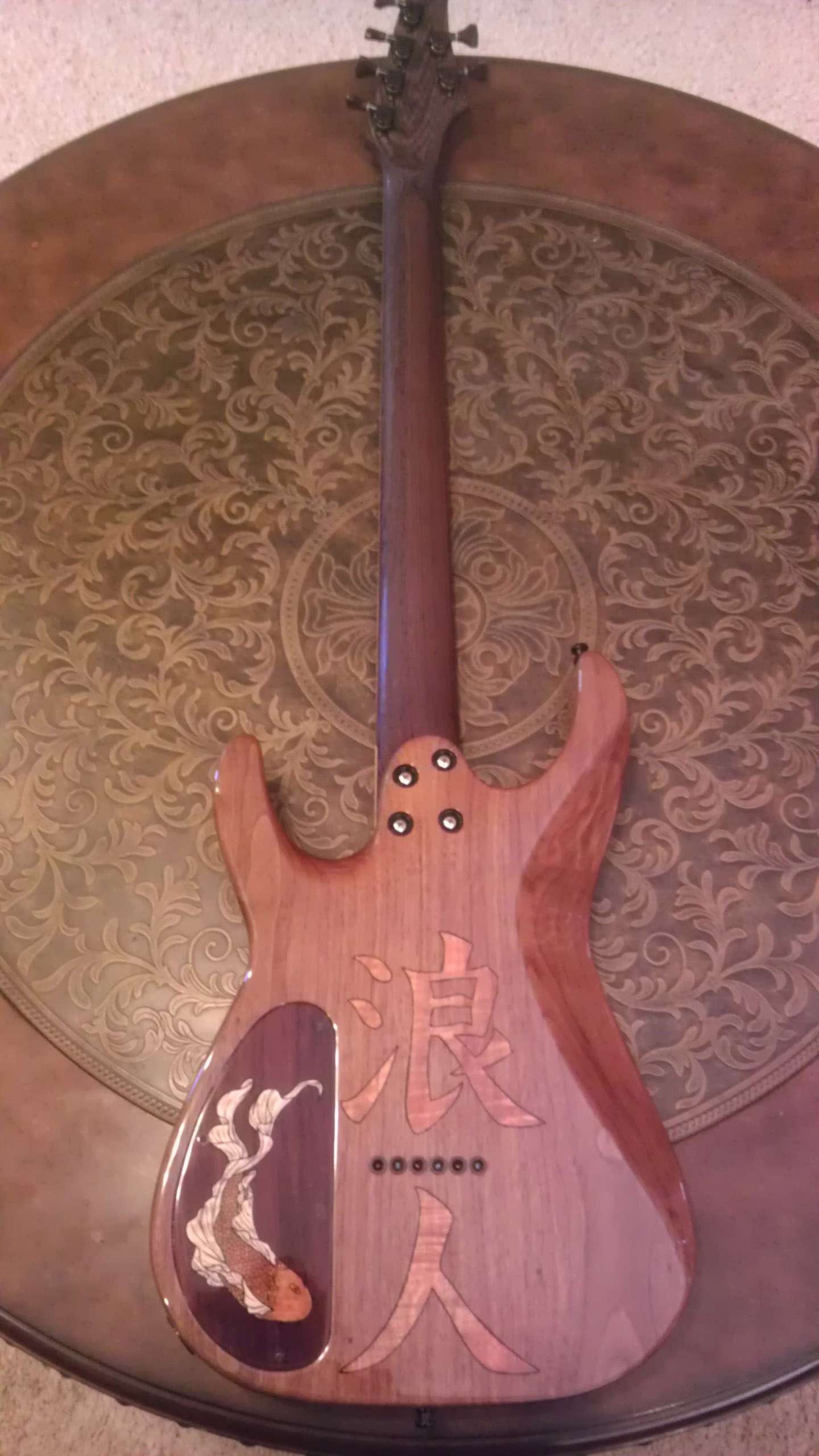

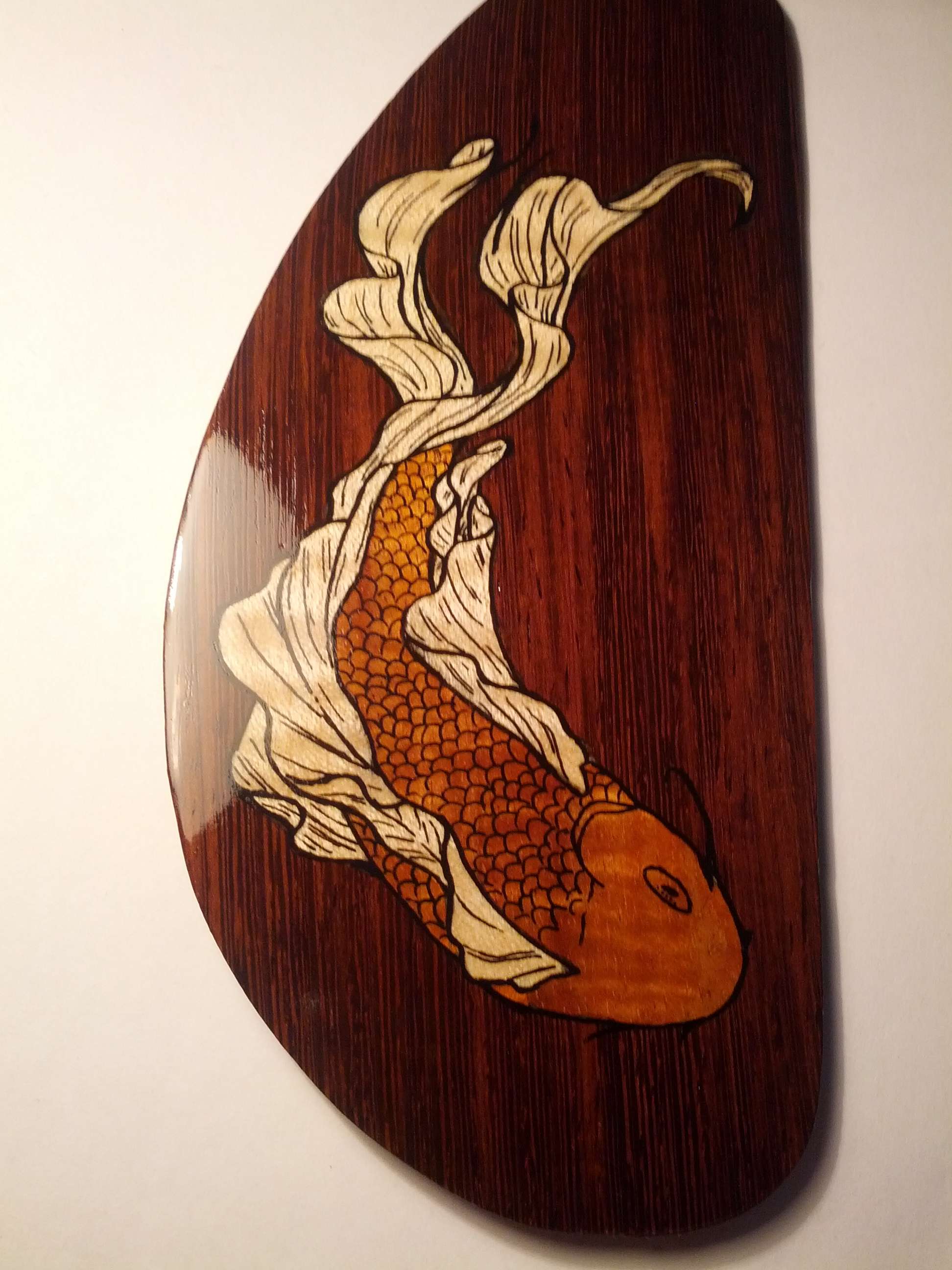

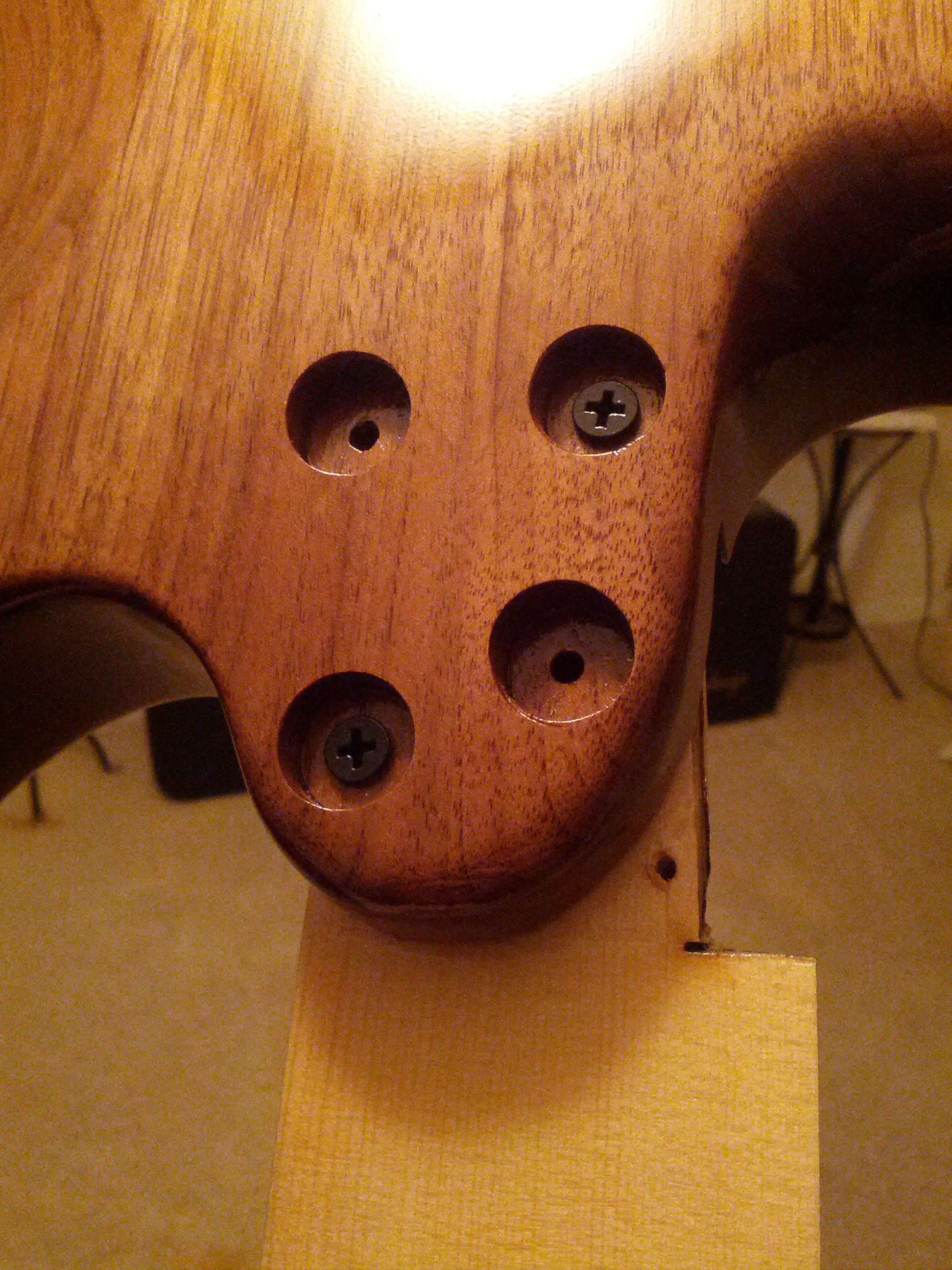

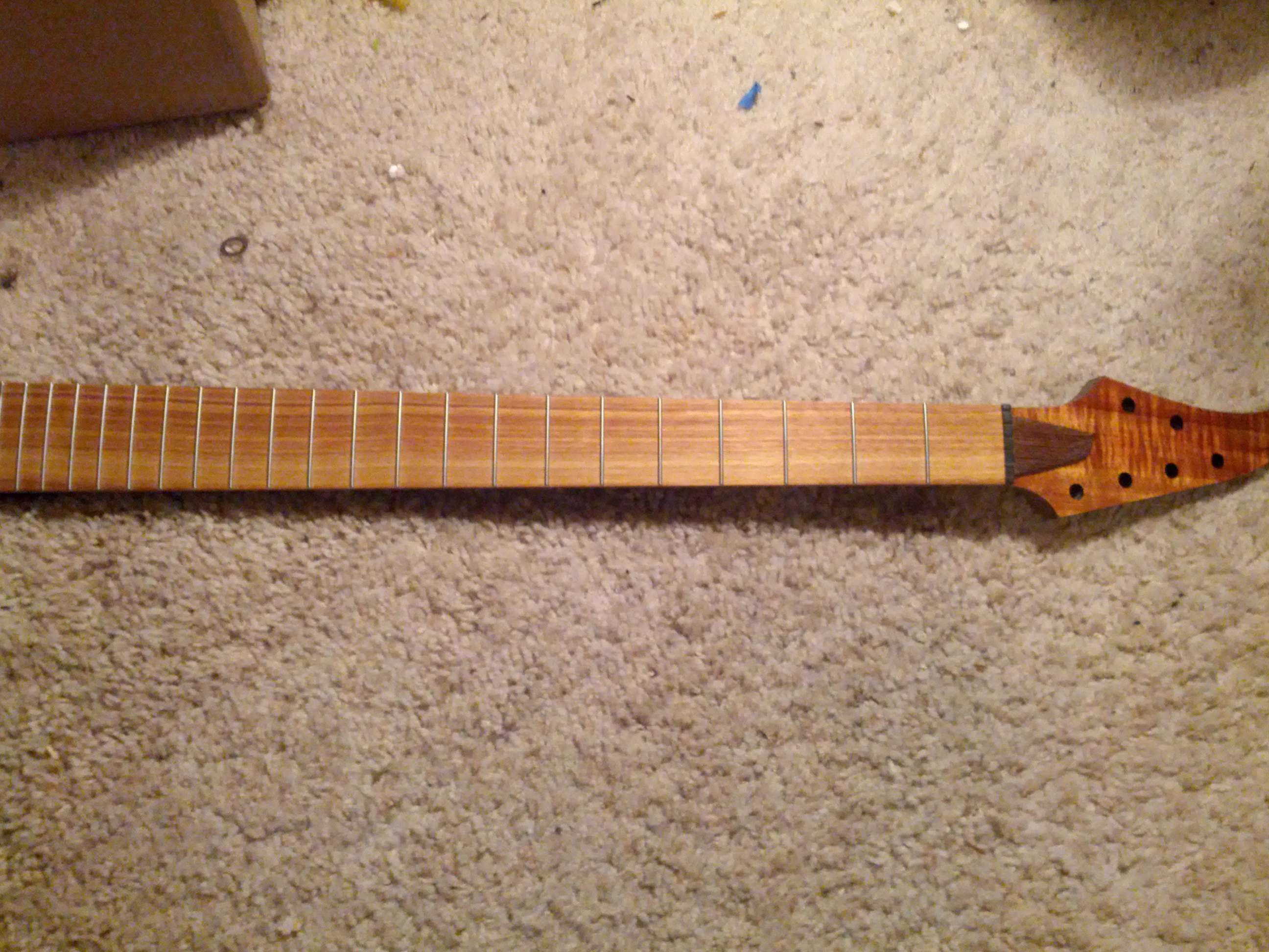

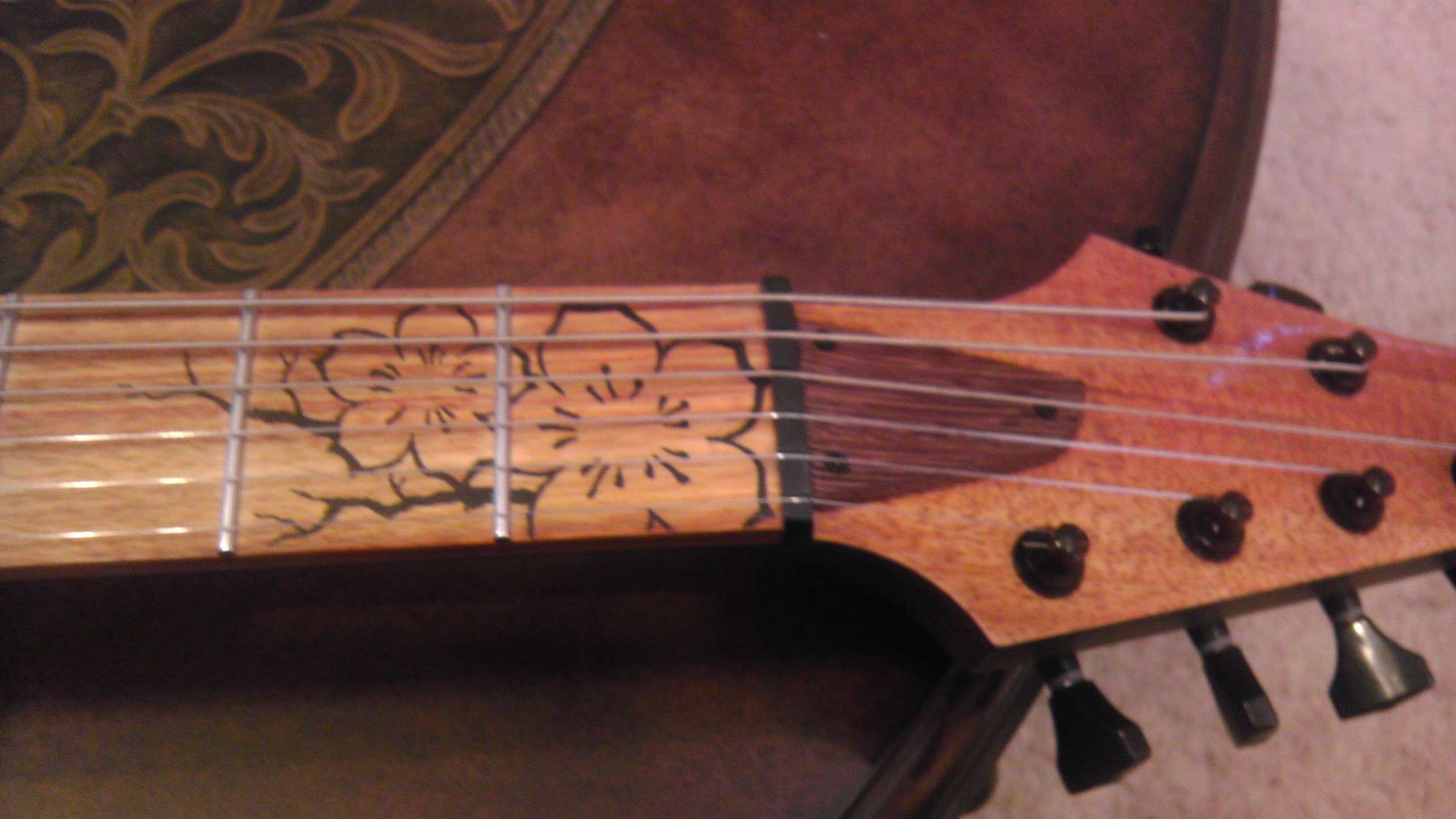

I will build the control cavity cover from a nice piece of wenge and maybe inlay some sakura cherry blossom in it to go with my samurai theme. You may notice I modded the heel to be more like an Ibanez AANJ. I prefer that feel.

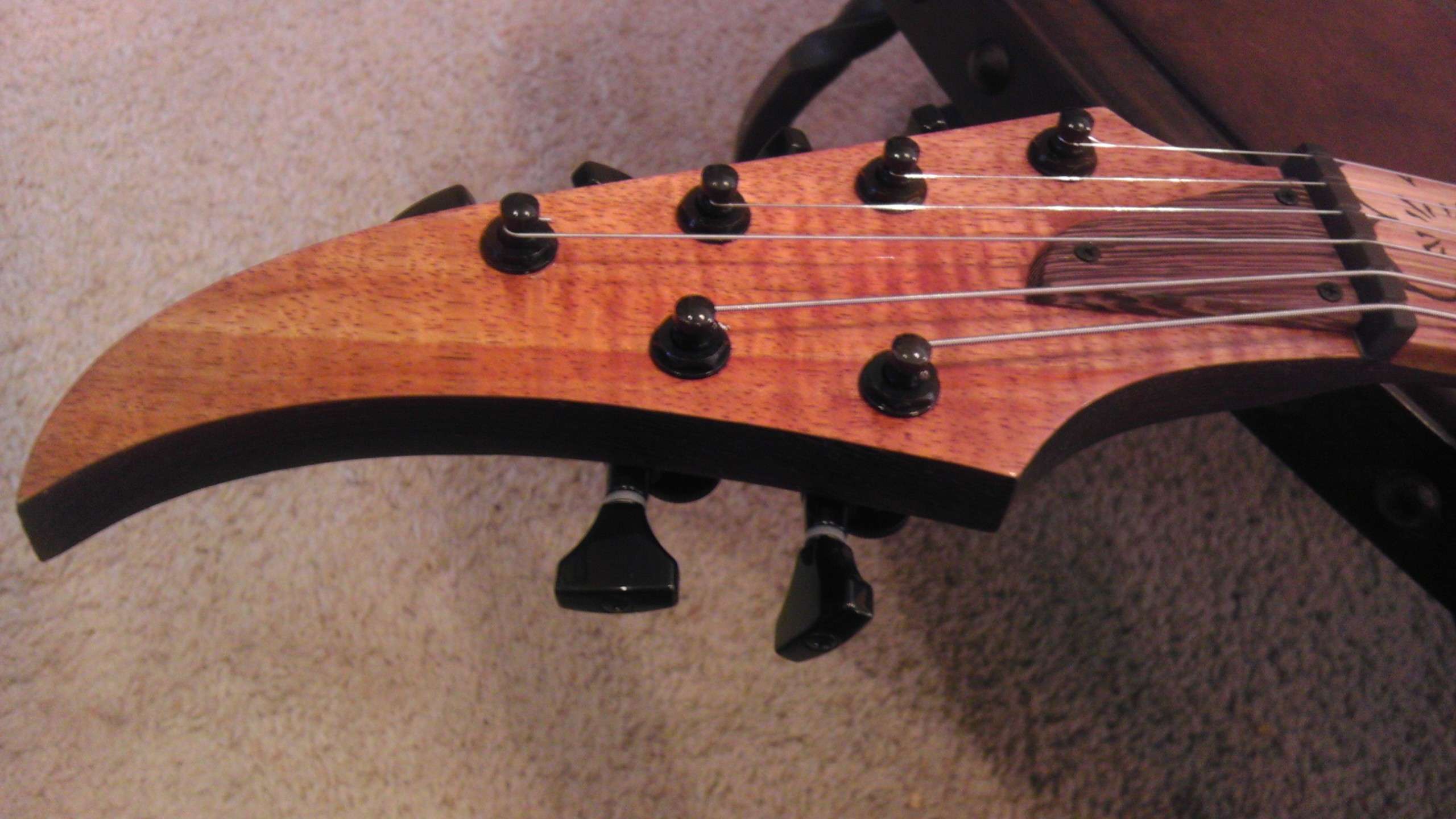

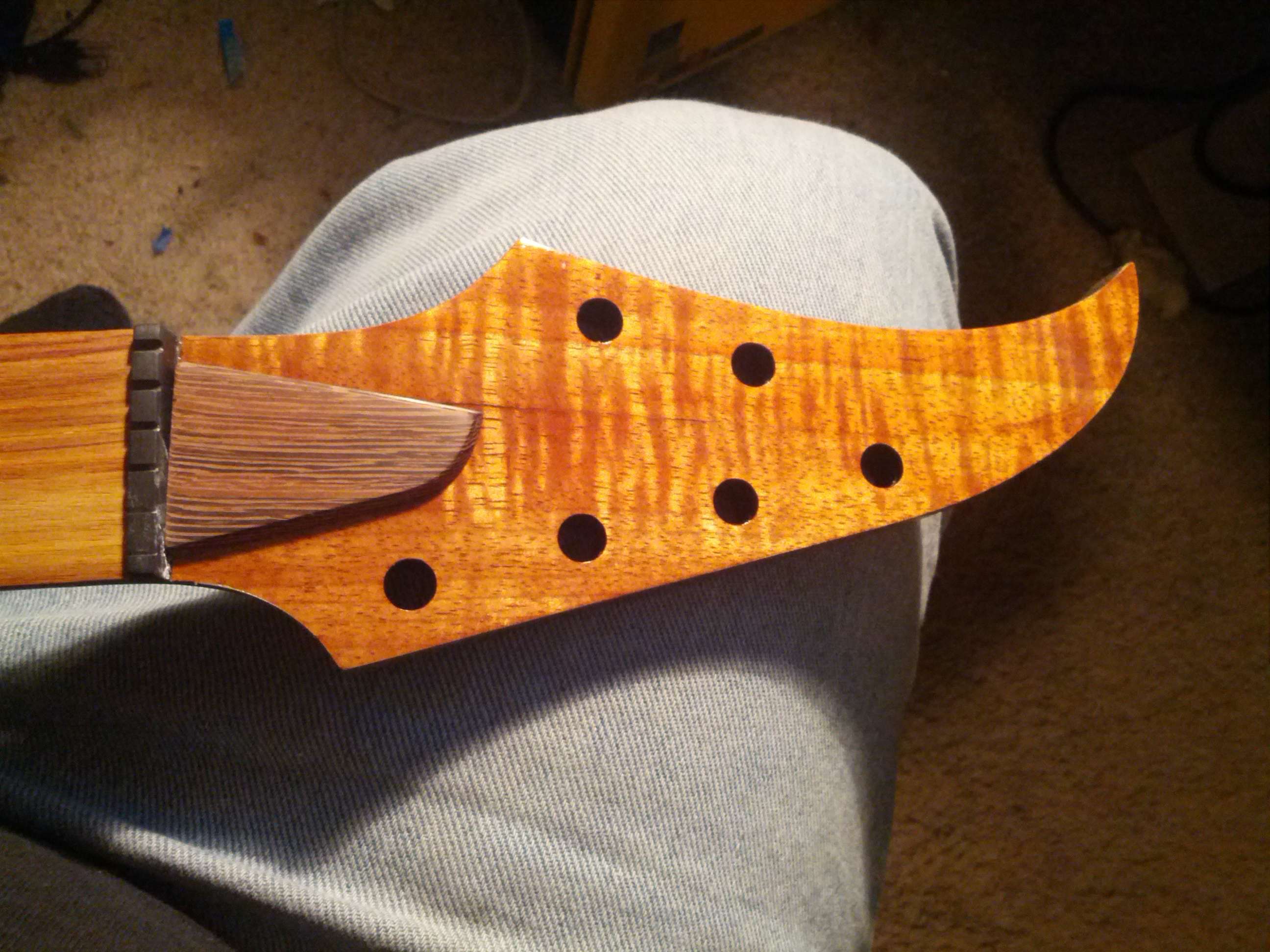

I will be putting a nice flame koa veneer on the headstock then I'll cut that out. More pics soon.
	Not bad right?
Here it is wet.
