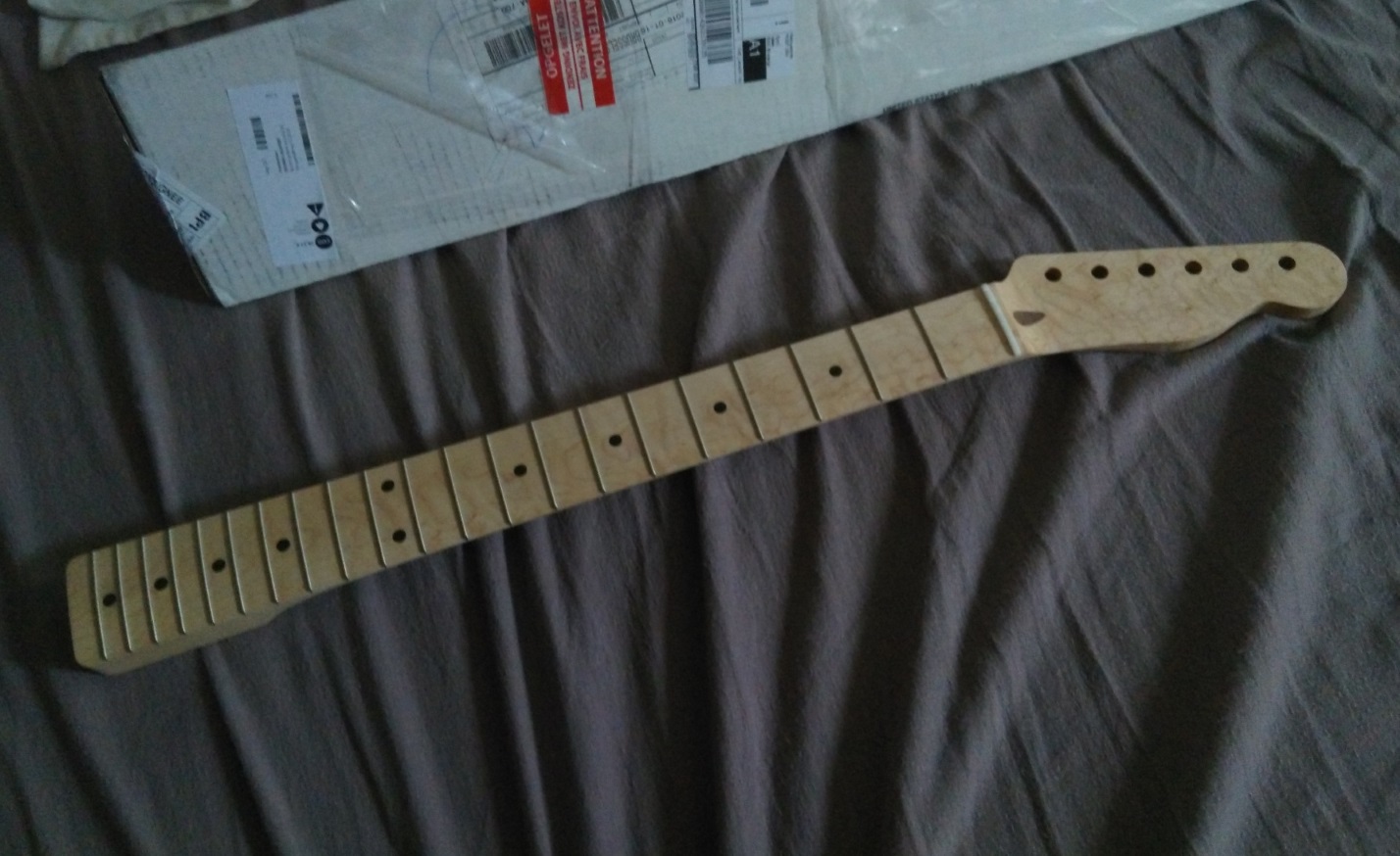

So, just in from Warmoth:
Vintage Tele neck, vintage construction. Showcase item, plain maple with bonus birdseye. The idea is that, in a couple of months, it should become the little brother to this:

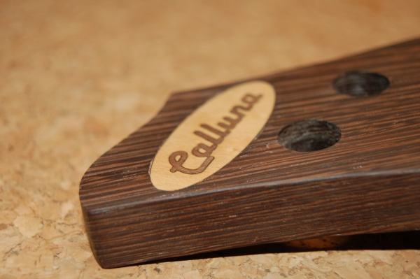

No, it's a separate laser cut part. I had my logo laser cut in maple and some dark (I think it was Wenge) veneer. The guy who did this very nicely packaged one oval with contrasting letters and matching 'C' and 'a' cutouts each to a zip bag. Dozens of them - must have taken him hours... So when I do a guitar, I take a bag with the right color logo. For a maple headstock dark oval, light letters, dark letter cores, for a dark headstock a light oval, dark letters and light cores. I assemble them on a piece of sticky tape, then stick them to the headstock with regular wood glue. When dry a bit of cleaning with 600 grit and then 1200 grit sandpaper, then I either (Tru-oil) finish it along with the neck or, if the neck is to remain unfinished, just the logo. These are a couple of shots that show the logo in a bit more detail. The first one I actually inlet the logo in the headstock but normally I just glue  it on top.

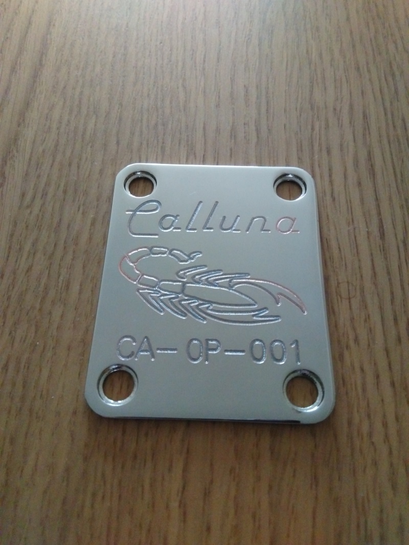

And just in from the Neckplatemeister himself...
Thanks Doug !!!
Thanks Doug !!!
So everything has arrived now, just installed the tuners and getting ready to tackle the body next. And chanced on a really neat idea for the tuner screws. Tuner screws and maple necks always make me more than just a bit apprehensive. I normally use some candle stubs to lubricate the threads, this time I decided to try something different and used some Coconut Shea Body Butter. The holes were drilled slightly undersize and still the screws went in without effort... Definitely continuing that way in the future...
You're certainly welcome Rene... :icon_thumright:
