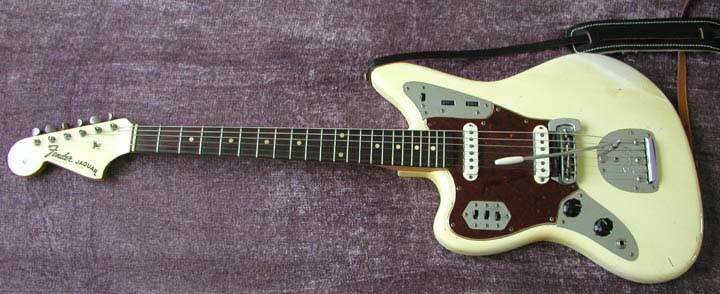

There's a '64 Jag. Lefty, but right handed bridge.
