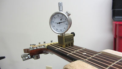

After installing a 0.5 degree shim I was able to raise both the base plate and the saddles to increase the break angle and eliminate the buzz. Because of the increased angle I was able to set the action to an amazingly low .040" at the 12th fret, on both the high and low E strings. I know, sounds like BS, but the gauge don't lie....
