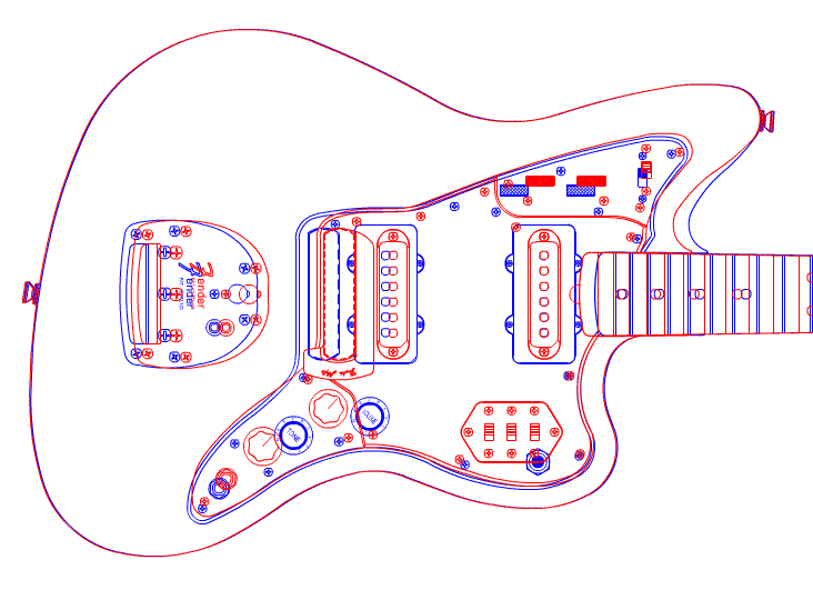

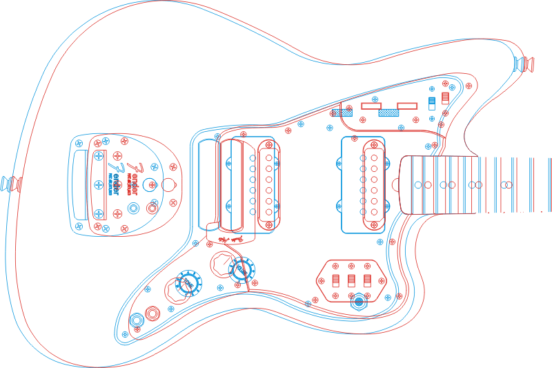

Here's a Jag sitting on top of a JM with the tails lined up.
Courtesy of the offset guitar forum is a picture of the two fender sized bodies with the bodies lined up, and then with the neck pockets lined up (plenty of excellent mods and restorations for offsets on that board, so they'd be able to answer your most of your specific Jag/Jazz offset questions).

Lastly, there's a JM in the Gallery done up to look like a Jag. The owner did the extra routing himself.
Thanks Pitchshifter. Your post was very useful and that picture of the JM in the gallery really let me know my idea was possible.
