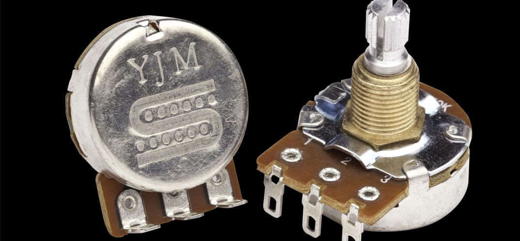

When at 100%, output resistance is measured at 9k, as advertised by my pickup's packaging.
As I turn down the volume slowly, resistance starts to raise, and when at 50% of the pot, reistance is araound 130k. It starts to decrease again as I continue to turn the pot towards the 0% position.
When I set the pot at like 0.5% (just above 0%), I see weird resistance fluctuations on the multimeter and it seems to go way over 4000k. Is this normal?
This is a B500K linear pot. I chose linear because volume would change too fast using audio tapers and 50s wiring.
I disgress. It's a matter of personal preference. Unless the linear taper would cause this kind of strangeness. If it's the case then I stand corrected.

Jumping around 4,000 kohms (4 megohms) indicates that the wiper of the pot has bad contact with the resistance trace. If some contact cleaner doesn't help, change the pot.

I'm always tinkering and checking how things work. I think the pot sounds good but I hear some crackle sometimes when turning it. I'll try some contact cleaner.

You have to remove the pot from the circuit to measure resistance...otherwise the pickup coil(s), which is an inductor, is in parallel with it, affecting your measurements.
Pots work as resistance to ground so, once you have your pot isolated, it should read ~500K at "10" and ~250K at "5" (+/– xx% tolerance).
