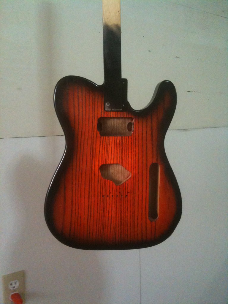

I have no experience with colors other than black. But here's an idea:  I found the India ink did a lovely job of blackening the grain on ash guitar that I then sanded back and dyed with General Finishes water-based dye stain and clearcoated with lacquer.
I'm (unless some other idea hits me I like better) planning this around a tort pickguard. That black grain fill is pretty, maybe it'd give a butterscotch a fighting chance at not washing it out. I have clear lacquer to go on top. I just wanted to make sure I wasn't barking up the wrong tree if I'm going to be shooting it anyway.
