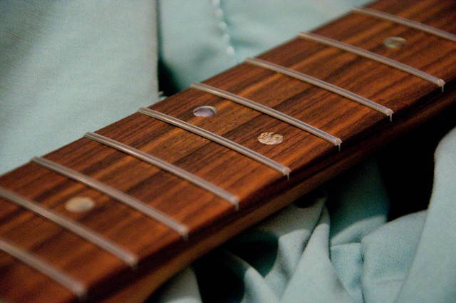

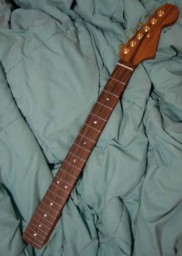

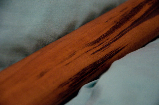

i think the goncalo/pau ferro combo is probably the most aesthetically beautiful option (see below) and the unfinished raw wood feels great. FWIW, I have a Goncalo/Pau Ferro neck in my closet that I want to sell if you're interested. it'd be cheaper than showcase and it's pretty much mint
(minus the tuners, unless you want to buy them too)
:rock-on:Thats. A hot neck. I'd love to see that on a white strat.  Alas, my next neck will be very specific and not a compound radius.  I love the look of something simple on my mahogany beauty.  Goncalo with ebony perhaps...

actually, my friend who's visiting from NY for a month or two just installed that neck on his trans-red American Standard strat and it looks great. The only problem is that I only had gold tuners to fit and the gold just looks god-awful against the reddish brown of the goncalo alves. Gold only works with dark. *shaking head*
