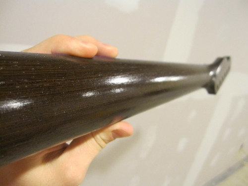

I have finally decided enough is enough. After having my new telecaster with a raw Wenge neck for almost a year I just don't like it. I have found myself no longer playing the guitar and always grabbing my old one. I just like the stick you get from a finished neck. So I am finishing the Wenge.

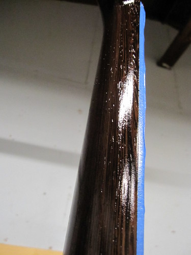

I am not going to do grain filler. I want to keep some of the character of the Wenge and a part of that is its open grain look. So far I have just finished putting on the sanding sealer, but already I have to say it looks amazing. The 'wet' look you get really deepens the color of the wood and makes it look nice.
The one thing I did do is mask off the face of the headstock. So from the front you will still see that raw look which I really thought matched the guitar well. I will take some pictures and post progress as I go along. I am sure there has to be at least one other person who doesn't like the raw feel...maybe :toothy11:
