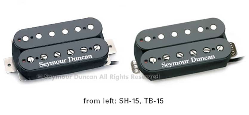

Wanting to build a hardtail strat with a Fender American Standard Flat Mount bridge and 1 11/16" nut. which will line up for better string spacing, trembucker or humbucker? I know both will work, id just prefer it to visually line up correctly.
Also do you guys know if the fat humbucker/trembucker pickguard option is the best for uncover pickups? as i prefer the rounded corners of the cutout.
Thanks in advance.
The string spacing of the bridge you mention is 2.08" which is the same as a Fender American Standard tremolo. The nut width is not really relevant for determining what you are asking about.
The next thing you need to do is look at which pickups you are considering and study the dimensions available. Once you know that you will be better placed to determine or ask about the pickguard option for the specific pickup.
Hey ,thanks for the reply. Was looking at the SD JB, and will bridge pickup only body. I assumed all brand humbucker and trembuckers had the same spacing (obviously these are 2 different spacings), is that correct?
I had a look at the SD website and they only give one spacing measurement and not overall (so x5 but its in inches and my brain explodes).
If you scroll down at this page, for example, you can see dimensions for different pickguard options.
Assuming SD JB is a Seymour Duncan JB this may also be of help
Also the bobbin of a trembucker is slightly wider. I would go for the trembucker version and the trembucker pickguard option. If you also email Warmoth sales they should also be able to confirm.

Some important things:
1. The bridge string spacing is the important dimension when choosing the appropriately-spaced humbucker. For a Fender-spaced bridge you want a Seymour Duncan Trembucker.
2. Seymour Duncan is the only pickup manufacturer I know of that actually uses different size bobbins for their wide-pole-spaced pickups (aka Trembuckers). This means a Seymour Duncan Trembucker is physically larger than their standard-spaced version, or the standard size of all of a humbucker pickups. It's very confusing, and very frustrating that first time you learn that your Seymour Duncan Trembucker doesn't quite fit in a standard humbucker mounting ring or pickguard cutout.
3. The terms "Humbucker" and "Fat Humbucker" on the Warmoth website pickguard builder are also very confusing.
Think of them this way:
  • The "Humbucker" and "Trembucker" cutouts have squared corners, to fit pickups with a cover.
  • "Fat Humbucker" and "Fat Trembucker" cutouts have round corners to fit pickups without a cover.
Thus:
  • Humbucker = the correct choice for standard sized humbuckers with a cover - all brands, regardless of pole spacing...except Trembuckers
  • Fat Humbucker = the correct choice for standard size humbuckers without a cover - all brands, regardless of pole spacing...except Trembuckers
  • Trembucker = for covered Seymour Duncan Trembuckers ONLY
  • Fat Trembucker = for uncovered Seymour Duncan Trembuckers ONLY
Also worth noting that on the upcoming new Warmoth website we address this confusion, and it will hopefully be more clear.

Personally I avoid buying a Seymour Duncan Trembucker.  For modern Fender guitars with modern spacing of 52.5mm, the standard size humbuckers are fine.  If you buy Dimarzio F spaced Pickup its actually better aligned with the strings - that's actually the ideal choice, whereas the other options are both compromises IMO.
Standard humbucker = 49.3mm
Dimarzio F spaced = 51.1mm
Trembucker = 52.6mm
The Trembucker is only *really* needed for guitars with actual Fender vintage bridges, some Gotoh or Wilkinson, and Floyd rose bridges.  Ie. ones that that have 54mm spacing.
For the 52.5mm spaced bridges, I would buy a regular humbucker and save the inconvenience of having a pickup that doesn't fit standard pickguards and mounting rings.
