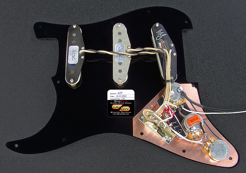

If it sounds like erratic static, it may be the pickguard. You'll notice on most pickguards that have controls mounted on them that the backside has a bit of foil over the area that covers the control cavity...
It's not there for shielding, it's to dissipate static buildup. Mounting the pots in that area usually grounds it because either the pot housing or a ground lug is grounded. Without it, and depending on the material the 'guard is made of, even a slight amount of rubbing will produce audible static in the output that the amp will dutifully amplify. As long as you're not touching it, you don't hear anything but the usual level of hum for that pickup/control scheme. In the example above, that would be a fairly high level of hum due to the antennae single coil pickups.
As for shielding the trem cavity? No. It would have no effect.  All lining your various cavities with foil does waste your time and money, and maybe make them look good in pictures to those who think doing so is a Good Thing.
