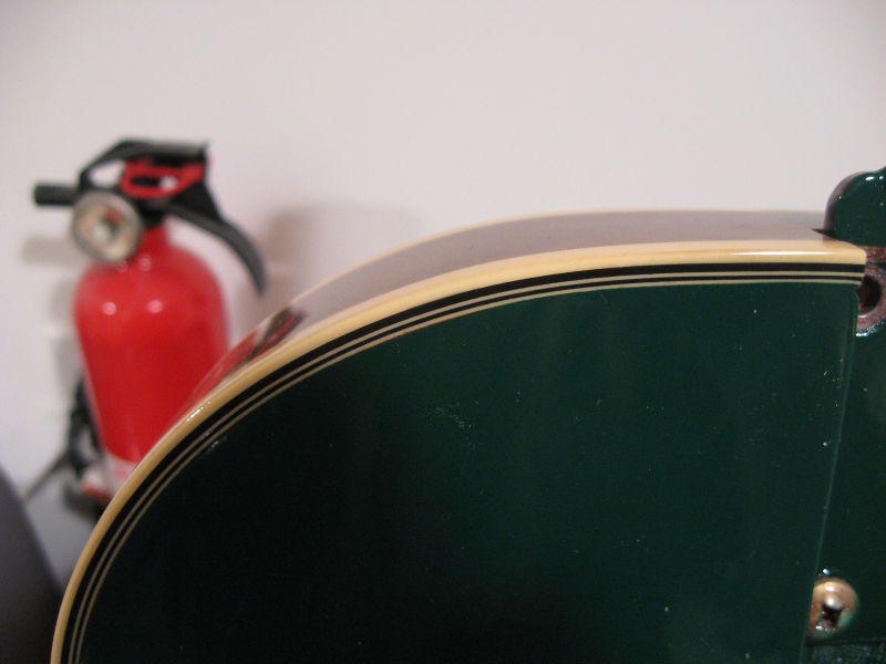

It's not British Racing Green. It's Cagey Green now.

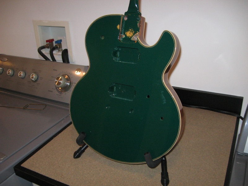

Still needs to be finish sanded & bufffed out. Been about 10 days now, so later this week. Neck's supposed to be here Friday and it'll need fretting and so forth. Hopefully, I'll be playing it sometime next week.
Loving your work Cagey    :icon_thumright: ... the binding you've done with that green is perfecto !!
Great touch with the clear sides and rear. Sets it off nicely indeed.
Is this the one having a Bigsby ? ..... I'm a guessing hoping in Chrome
Is it chambered / hollow ?
Now ..... I'm expecting a WOWZA neck to complete this beauty.  :icon_biggrin:

Pretty Darn close though, it is definitely super close to Jag/Mg green
Well, if finally dawned on me that I wasn't trying to color match for a repair on an existing finish, so all that work trying to nail a particular shade was unnecessary. Just mix until happy, and shoot it. It's close enough for rock 'n' roll, and I'm happy.

Thanks!
This is the one getting the Bigsby, but it's going to be in gold. There'll also be a Wikinson roller bridge, and I've got a couple Bill Lawrence L600s to put in it. They ought to be interesting. The body isn't hollow or chambered, it's solid Mahogany. Very nice piece that I could have left natural, but I had to plug a lot of holes in the top so it had to have an opaque finish.
The neck is a unique choice Canary over Canary part with the Warmoth 2 headstock and cream binding to match the body, no inlays. I got some FWG110 gold fretwire from LMII to put on it (same wire Warmoth calls 6100G), to match the rest of the hardware. They've got a new fret tang removal tool I'm going to try that precludes the need for fret nippers, which wear after one job on stainless or gold wire. Should look pretty nice.
