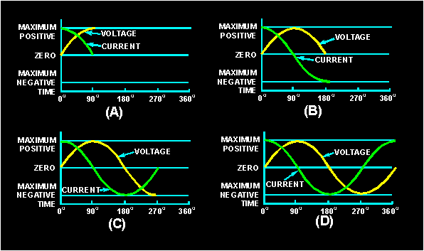

Wow, I feel like a dolt.  Although it is 90 degrees, CB.  :)  The phase relationship of voltage and current in a capacitive circuit:

i looked it up, ok a purely capacitive curcuit has a -90 shift. a cap in series with a resistor will have a lesser shift, now i didn't study the math for long and wont claim to fully understand it but i suspect that a low frequency will have a greater shift than a very high frequency. the cap is the greater sorce of impedence at low frequencies and i'll bet that the shift comes closer to a perfect capacitor. ok now an inductor will also have a shift at +90 degrees so in reality the math is complex and will give me a headache.
i should mention this is used in single phase ac motors. there is a "start winding" that is in series with a capacitor. this gives another phase offset from the ac source. the second phase gives a circular motion to the magnetic feild. without it the motor might not turn and if it did would have no reference for direction.
