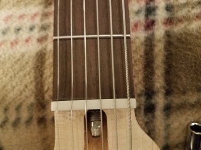

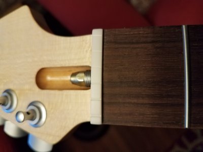

Looks like it was cut for 3+3 (by Warmoth), the D through high E are most obvious in the extreme slant. I contacted Warmoth and they suggested widening the back ends of the slots. Anyone else have experience with this?

Looks like a great opportunity to invest in nut slotting files!  Just remember to go at it gradually, or you will then get to learn nut replacement.
I see ... they were cut not straight, the d, g and b slots seem to be angled. Can you post a pick head on showing the full head stock and the first fret.  I’m curious if the strings head straight to the tuning pegs or if they zag again and by how much. If they go straight to the pegs and you like the string spacing on the fret board it could be nothing.
It’s been almost 20 years since I owned a warmoth tilt back strat neck and the slots might be angled to accommodate the tilt.  I can’t remember ... Did warmoth say the way it should be?  Did they say an angle in the nut slot is normal?  I’d rely  on what they say.
Exactly - they are angled a bit that isn't exactly a straight pull through to the tuners. Warmoth advised me to work with it, not sure if it was 100% right from the shop but the strings were creaking during tuning on the D through E. Low E & A were really good right away.
I filed the back openings a little wider, creating more of a guide towards the tuners with straighter string pull. It wasn't much but really helped a lot so far. They did advise me not to trim down the height of the nut slots, but they are all a bit higher than a normal setup so I'm probably going to bring the whole thing down from the bottom during next string change.
It is not correctly slotted and filing it may help but basically if it was me I would remove that nut and replace it.
