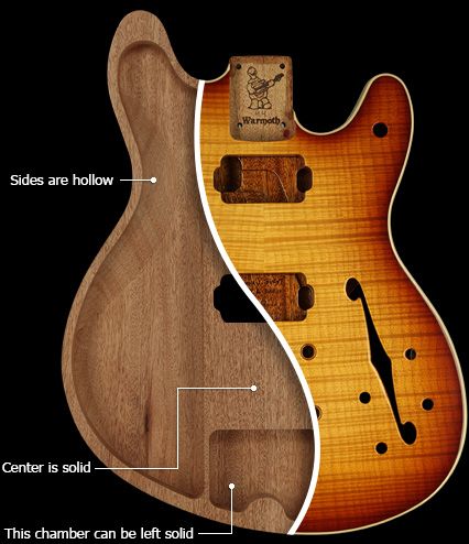

All the classic Gibson "ES" guitars had full laminate construction (top, back, sides), same with the (pre-Gibson) Epiphone "Zephyr" series. The idea was, since these were dedicate electric guitars, that the laminated wood would hamper feedback. Remember these are built like an acoustic or archtop, bend sides, top and back, held together with kerfing, they vibrate more ...
The Mooncaster is more like a chambered "thinline" (the back is routed out of a body black, like the Gibson ES-/CS-356), the body is more than rigid enough to fight feedback ...
Considering the construction differences, whether the top is laminated, or what wood is used, probably wouldn't make any difference. I agree with the others that a Gibson scale-length and PAFs, and the right licks when playing, are close enough.
