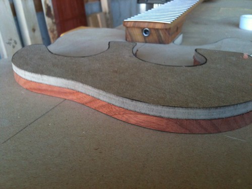

I personally liked Warwicks, but not the straight lower horn, and I liked Spectors but not the symmetrical butt. So... this is the shape I came up with.
The profile was asymmetrical when I first cut it out, and when I revised it this year (almost 10 years after cutting it out), I made sure the waist on either side was equidistant from the mid line, as well as the widest points of the butt (If that makes any sense).
The mockup obviously has more detail than what'll be in the finished product, but I'll take my time, try to pull it off as great looking as possible. If I don't like the product, I'll scrap it and make a simpler bloodwood cover.

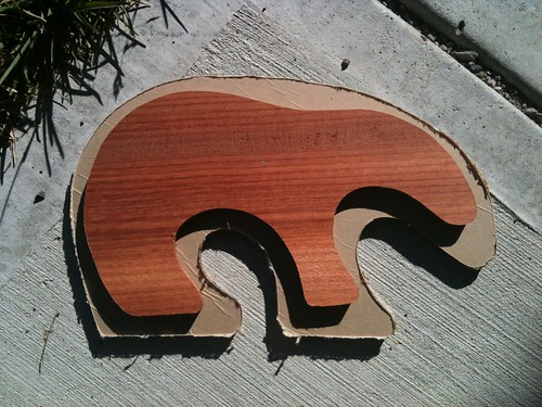

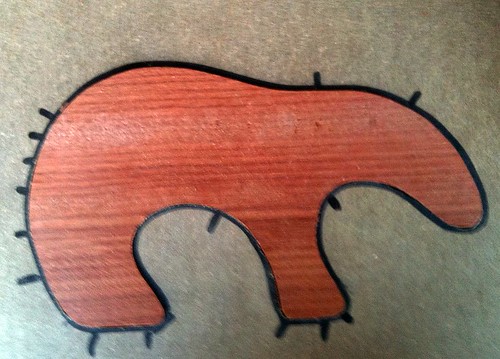

Despite the necessities of life, I went ahead and started working on my cover.

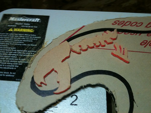

First made the shapes out of some scrap:
traced from a paper cutout, cut on a scroll saw and or bandsaw, sanded with the drill press using the lee valley kit. It was a breeze.

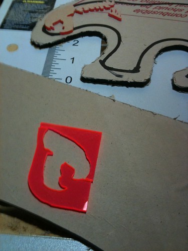

Then routed the bloodwood and the acrylic (after having cut them to within 1/16")
1. 119$ for this router and table at canadian tire now seems like a steal - it works great!
2. Routing acrylic sucks. The end result is fine, but it smells, and the little flakes come off the router at 3000°C, and a t-shirt is no adequate protection. On the upside, once they cooled down, since I didn't clean up, it snowed acrylic flakes in my shop (literally) every time I turned the router on.
- haven't yet taken the protection off the acrylic.

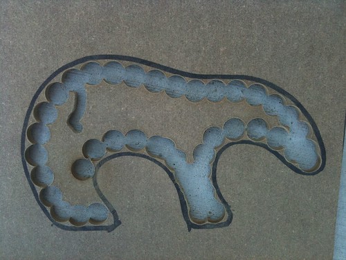

So as to rout the acrylic to be able to inset the bloodwood, I thought it would be a good idea to make a template.
Bane on my existence.
Using a forstner bit:
Cleaning up with a 1/4" inlay bit on the router table and the sanding press:
I'm not satisfied with the result, but it's not really going to show once the cracks are filled in with CA.

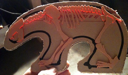

I'll mock it up without the bones, see how I like it. At least I'll be able to finish my wiring. Add the bones later? My template making experience is turning me off hard. Not so much flaming-skulls-ish without the bones though.

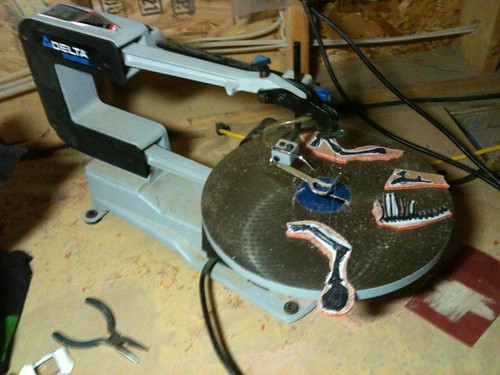

Decided to try my hand at cutting out the bones.
Wife's scroll saw.
Spiral blade - man those things are awesome, but do they ever break! Good thing they're cheap. Had to go with a hybrid approach - some with a small normal blade, some with a spiral blade. The kerf is actually quite thin with the spiral blade - I was pleasantly surprised.
Stuck a copy of my model using spray adhesive.
I'll inlay the bloodwood into the black acrylic,sand flush. Inlay the bones. Sand flush. Then it's going to be used as my control cavity cover...
