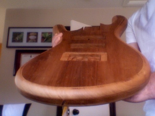

quick post to say I routed the pickup cavities and the body roundover today. It was soo much fun.
Learned a few things:
  • MDF is the worst for adhoc templates
  • You can rout more than 1/4 deep, as long as it's (much) less than 1/8 thick
  • The 2nd pass with a 3/8 bit isn't really necessary for a HB
  • That screw that prevents your router from going deeper - it's actually useful
  • That screw that prevents your router from going deeper prevents you from having to make pickup rings
  • Making pickup rings sucks
  • Roundover is a fluid concept
  • My uncle is a cowboy
  • I like making my work pretty as I work
  • That screw that prevents your router from going deeper should be tight

So - I have two Artec Giovanni's (slim bubinga) I got used from tubby.twins (pleasure to deal with), and a q-tuner (BL4) I also got from t.t.
The bridge is an el-cheapo until I can afford the Ghost.
The neck rout went fine.
The middle rout - forgot to tighten that screw - and the plunge router did just that - plunge. Hence the target in the middle of the rout.
The bridge rout - um... well, I'm ashamed. Got greedy, routed too deep, bass wasn't clamped well, and, well, lets just pretend I always intended to put a pickup ring on the q-tuner to "balance" things out with the other 2 pickups. The look will not suffer. I swear.
And contour routing - my uncle had a 5hp router (that's huge) and the thing is a beast - never slows down for anything. And since the mahogany was WELL aged, there was 0 tearout - even though I just routed counterclockwise in (almost) 2 passes. Got lucky.
And I just noticed that my laptop's camera does funny things with pics - no, I'm not a lefty.
Thanks!
