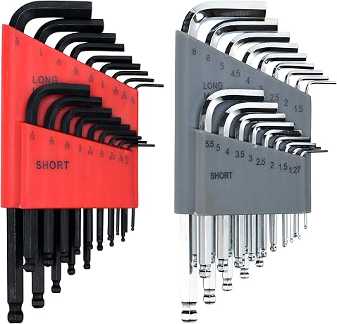

I purchased a Modified Mustang Bridge (Item: WMB1C) a few years back and want to adjust the saddle heights.  Does anybody know what size hex wrench should be used to adjust the screws on the saddles? I tried contacting Warmoth with this question - but did not receive a response.

I don't know. But, that's because I rarely need to know. Buy a couple sets of hex wrenches in imperial and metric sizes and you'll never have to worry about it again. This set...
Is only $11 from Amazon.
No problem. Figured if you had any to try, you wouldn't need to know the size, and if you found out the size you'd have to buy it anyway  :laughing7:
The hex wrenches arrived today...so in the interest of tying up loose ends (or screws).
Bridge Post Adjustment - 1/16 in. wrench.
Saddle Height Adjustment - 0.05 in. wrench
So there ya go...case closed :)
