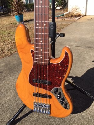

I have attached a picture of one of my bass guitars. It was finished by Warmoth. I picked the alder body with the best grain figuring from their site and had them finish it in vintage tint. I really like the color, but I agree with others about most alder bodies have an uninteresting and not very visible grain figure. I don't think it's ugly. Poplar is usually ugly and usually needs an opaques finish. I would definitely have Warmoth do the finishing unless you have experience finishing wood.
