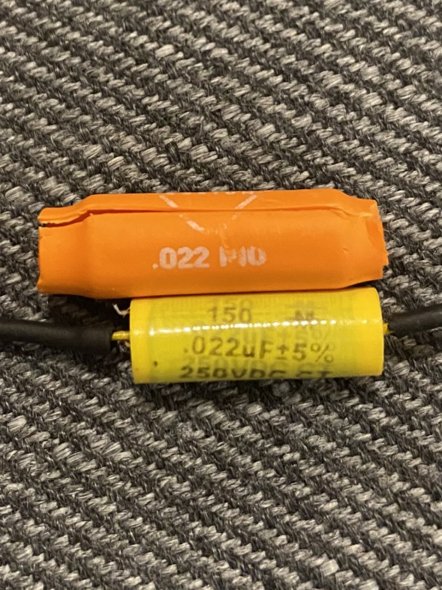

It wasn't a quality control fiasco...they were shrink-wrapping over $1.25 Mojotone Dijon (polyester) caps and reselling them as paper-in-oil caps for $28. I don't think 920D gets much repeat business, their business model is more about marketing blitzes and being the most prominent, slickest brand when people are looking for parts.
c547d6ec-b0c2-4958-ae75-62037f2436f3-png.1057408
