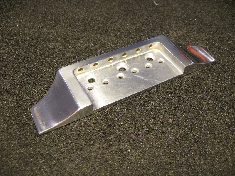

Well, I can share a bit of oddity... those three "mounting holes" are of course the same holes to mount the block, right? I bought one of these online:
http://www.ebay.com/itm/290592848125?ssPageName=STRK:MEWAX:IT&_trksid=p3984.m1438.l2649
And to my surprise, I saw that it has the same three mounting holes as this:
http://www.warmoth.com/Schaller-475-Flat-C712.aspx
And lest you be wondering why Schaller would even PUT rollers on a string-through, it's because all they really did was saw off the arm and pivots from these:
http://guitar-tremolo.com/hp135040/Vintage-Tremolo.htm
It does take a tiny step towards standardizing parts, at least among Schallers.

The hardtail is a bit narrower, 1.400" and the trem replacement is 1.750"

Incidentally, I managed to clean up my aluminum Scartozi bridge today. This thread inspired me. It was useless as it was, and I certainly wasn't going to throw it away.
Anyway, it came out fine....
I used the "oven cleaner method" since I've still got some of the good stuff from the plating removal debacle. Took it off fairly quickly, but I had to make about three passes at it because I kept cleaning it off too early. DIdn't want to eat the aluminum.
In the end it was still a bit etched, but at least not pitted or anything. A great deal of elbow grease and 5 grades of polishing cloth took it where you see it now. There's still a tiny bit of anodizing left in the inside corners, but you'll never see it once the saddles are installed. So, it's useful once again.

Well.....my plan for the wood bridges is to rout out the base enough to inlay a piece of 1/16" steel for the saddles to sit on :icon_scratch: And, yes, 3 mounting screw holes.
As far as the mounting holes go, Doug and I have messed around with dimensions and I believe (correct me if I'm wrong Doug) for the hardtail application ONLY we're doing the mounting holes at the same location  regardless if it's vintage or standard string spacing. I believe we used the mounting hole spacing of the vintage bridge for this. Now, trem versions are different, they will be to factory spec.
Ddbltrbl: What string spacing do you need? I have one in Vintage string spacing ready to go and it wouldn't be a problem to put holes wherever you want them. I can do some 1/16" or 3/32" holes right behind the 6 mounting holes. Its something I'd be interested in doing because I plan on installing the Ghost System someday. We can do whatever you want.....I know if it was me I'd want to hide the wires.

Gotta love the good ole toxic oven cleaner. That's what I used to age my brass jackplate and bridge, works great on brass!! I learned my lesson with paint stripper.....if you buy the "green" crap the only thing it strips is your wallet of some green! GO TOXIC and get it done!
Thanks. It looks good again, so I'm happy. I've still got that black cherry carved-top Tele body sitting here just rotting - nobody's bit on it yet - so maybe I'll change the hardware scheme to chrome or nickel and finish that off. There's a Wenge/Wenge neck up for sale that I'm waiting to hear if I beat anyone else to. That combination could work out to something nice. Maybe make a nice Christmas gift for one of my brothers or my Tele-obsessed niece. Or, I could finally set up the Nashville-tuned guitar I've been saying I'm going to do for a while now.
