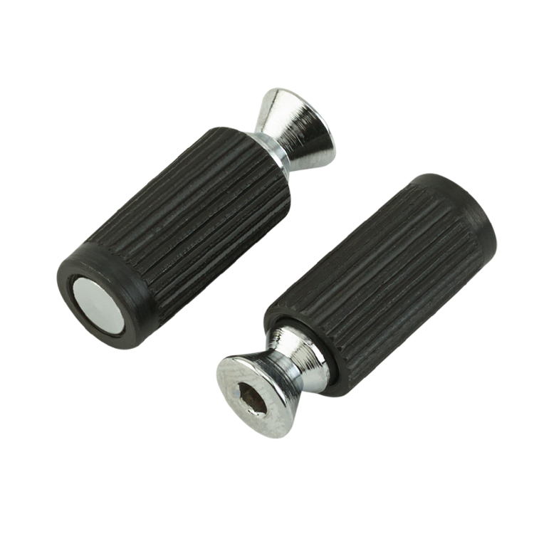

I strongly advise using inserts (I didn't even know you could get the inferior screws anymore!)
You can have them fully seated and still adjust the height of the interior screw with those.
Even all of the EVH branded guitars currently in production, all the way back to EVH's association with EB/MM, the above posted stud inserts have been used.
The only reason that the wood screw type were used on the Frankenstrat is that those were the only ones available when he dropped a Floyd on there some 30+ years ago.
