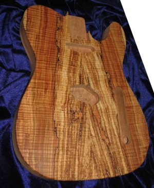

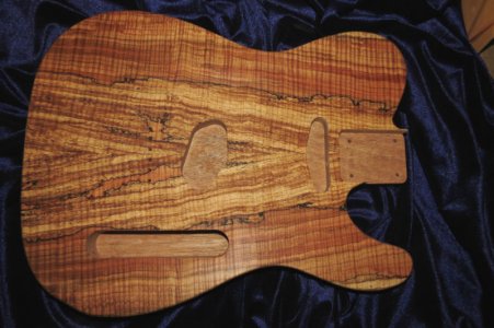

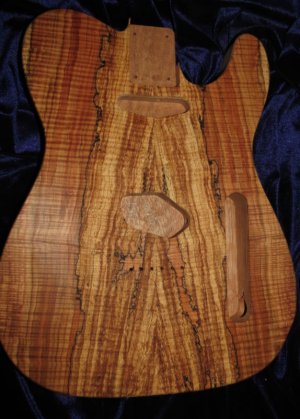

Ive ordered a flamed spalt maple tele body with a mahogany back and some bill lawrence keystone pickups. I would prefer the body to be rear routed but hey im more than happy with what ive got!
Still deciding on what neck to order, im thinking a dark wood like wenge, rosewood or pau ferro will match up with this body nicely
Just thought id share this with as im real excited to build this.
The body will be getting a clear coat of some sort, and I intend to use all black hardware

That's a very attractive body. I'm not normally a huge fan of spalt, but I'd take that one any day.
As for the neck, I'm not sure I'd go dark woods. I think I'd do something a little lighter for the neck meat to add contrast, and non-descript on the fretboard. For instance, Ebony over Canary would be great. You don't want to draw the eye away from that body. Some big, fat stainless frets, and you're there.

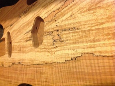

Very nice example of spalt you have there.  One tip is make sure you use some epoxy on the spalt.  It is some super soft stuff.  The epoxy will help protect the wood from dings.
I know myself and Dolando have experience finishing spalt.  Feel free to reach out.
Thanks for the advice and feedback guys, I like cageys suggestion of something like ebony on canary for the neck.
Ive been doing some research on stabilizing spalt, some have suggested using thinned ca glue and others minwax wood hardener to sort out the 'punky' wood.
What epoxy did you use dmraco?

Zpoxy finishing resin.  Much easier than CA glue.
Here is my build thread.  Page 4 starts the z poxy discussion

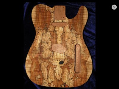

I recognize spaltkings handy work here. Don't know where they are getting it but they have some amazing spalted maple. Be very careful though. My build was going to be with the body pictured below but it is now in a box in the garage because I didn't do my research on how to sand/finish/handle spalted maple and ruined it. Live and learn. Good luck to you sir.

What happened??  Never throw anything away!!  We can rebuild.  I would love to see what you have
Wow that is an amazing piece of maple. Surely whatever has happened can be recovered?!!?!

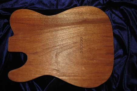

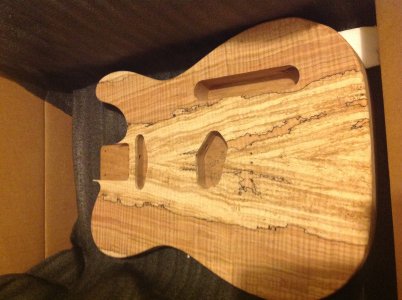

So she finally arrived, and now the fun really begins!
The maple top is well sanded but the mahogany bottom has a few rough bits that need to be sorted out.
The goal at this stage Is getting some epoxy onto the maple to ensure its integrity and grain filling the mahogany

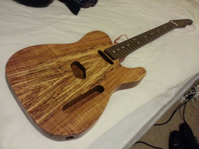

I've applied about 4 coats of Danish Oil on it now and it's starting to get some sheen now. This is a photo of the 3rd coat
That thing is gonna be real showpiece! Won't be able to take it out of the house. People won't wait until you're not looking, they'll just smack you and take it.
Phaedrus said:
Man that is beautyful. The oil really adds to the wood's definition. Love it!
yes it does, but problem with the oil is it doesn't protect the wood. It needs to be covered in a hard finish like polyurethane. I covered mine with epoxy, it'll last longer than the wood... :laughing7:

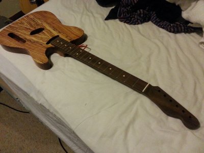

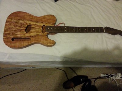

Sooo today is new neck day!
Here is a couple  of pics of the neck and the body saying hello to each other for the first time in what looks to be a long relationship
