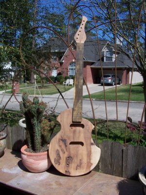

Sorry for the non-Warmoth content......
This guitar knotty enough for ya!? ;)
It's being built for me by a guy in TX....spalted pecan body, Texas ebony fret board, mesquite neck.....
