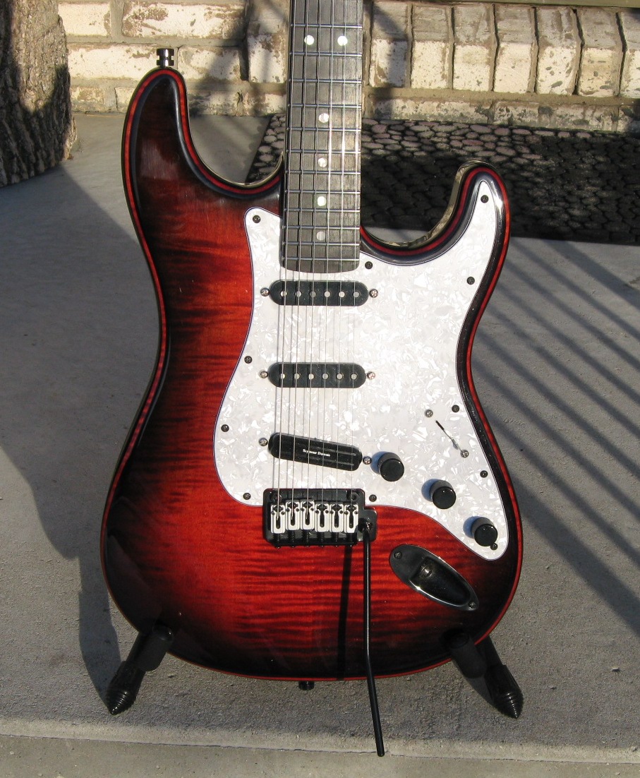

Sometimes they'll do a masked binding that includes the top tint rather than a natural mask. For example, my red Strat has that effect...
If you look at the "binding" edges, they're as red as the top. The curly maple still shows through, but it's not "natural" colored; it's red. Imagine that with a midnight blue burst...
