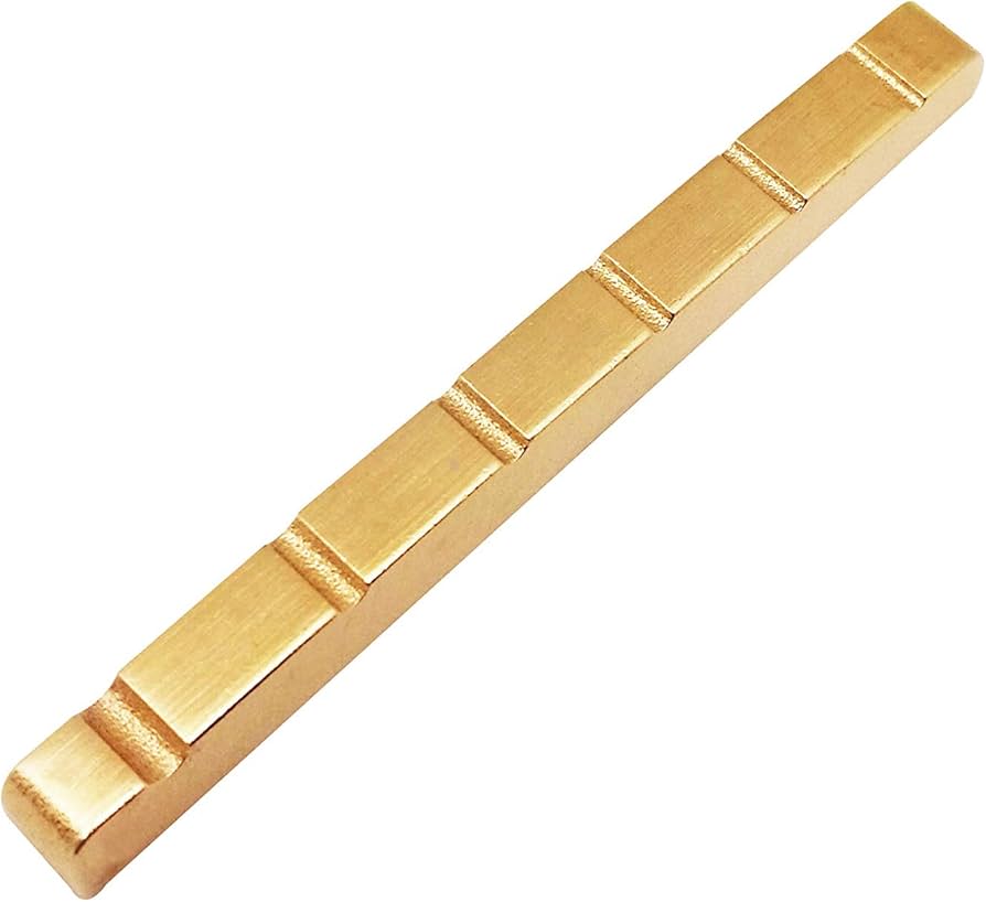

I've used an LSR nut for decades on my main guitar and find the whole shaping/replacing process frustrating for more typical nuts. I'm having issues with the TUSQ nut I'm using now and am wondering if brass (or possibly even steel?) would be worth trying. Any strong opinions?
I have several guitars with brass nuts, mostly Alembic or Alembic influenced. They do seem to make open strings sound a little more like fretted strings, but it’s subtle and probably not noticeable in a band context. They do look cool and appropriate on a “hippie sandwich” instrument. Not sure why you don’t like your nuts. I have guitars with brass, black and white Tusq, unknown plastic, and bone nuts. Never had any consistent issues with any of them.

Brass nuts were popular for a while in the 1970s, because people felt they improved sustain (but they also went out of their way to buy heavier guitars for the same reason). Something about the brass nut always felt a bit muted to me, it's a relatively soft metal, so if anything I feel it dampens vibrations, not sustains them. But to each their own, I stick with bone (rhyme not inteded but acknowledged none the less)..

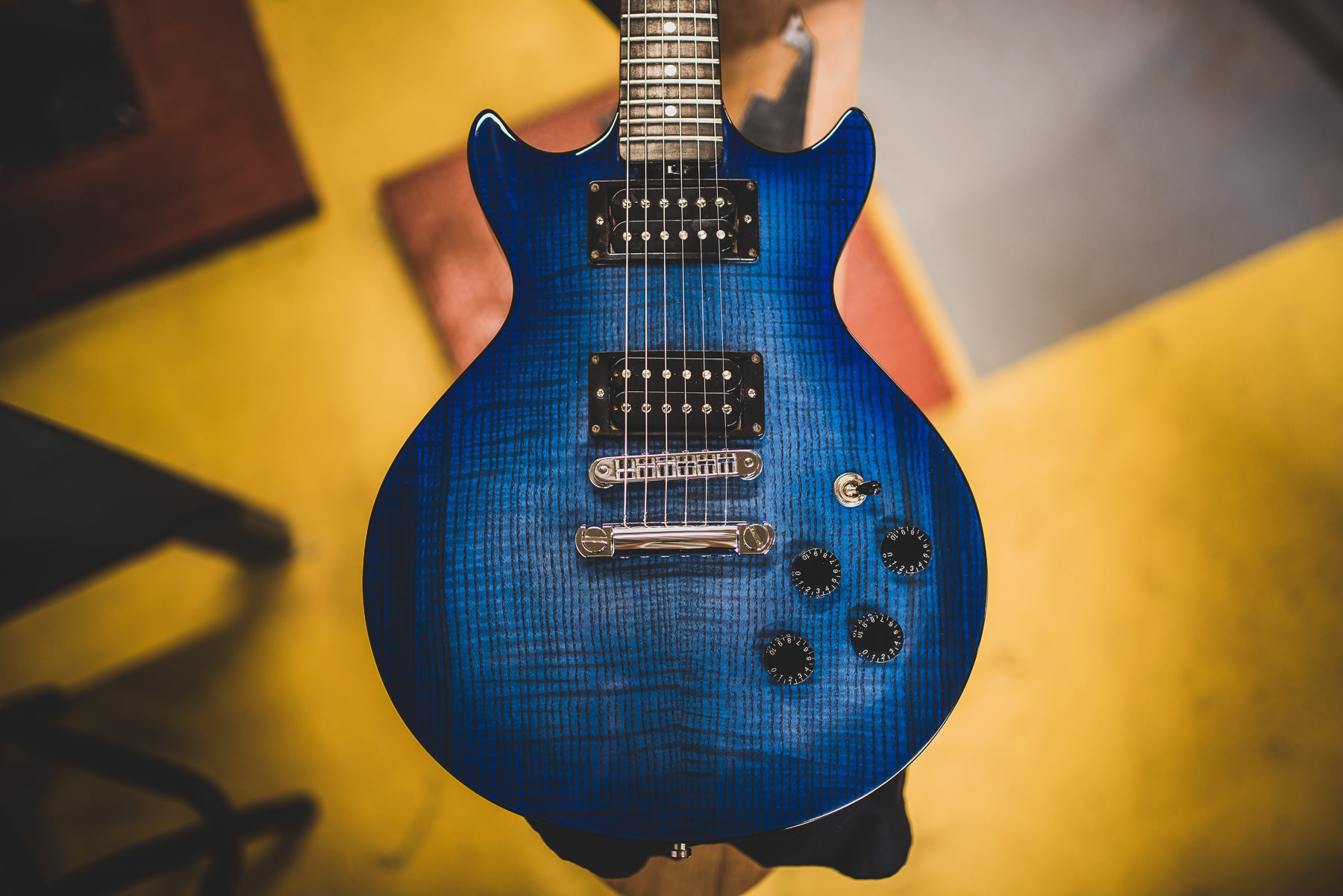

I recently got a Gatsby from Gordon Smith https://www.gordonsmithguitars.com/shop/guitars/gatsby/
Fun fact about them is that you can order a guitar from them with basically any options and mods - except the nut. Their ”thing” is the brass nut that they supply on all their guitars.
