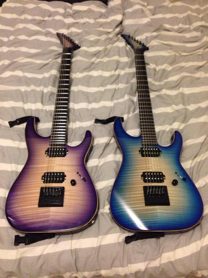

And no, I'm not the first one ordering Evertune guitars from Warmoth. A friend of mine has ordered one two, which is now even having True Temperament frets installed on the neck...  I want too  :toothy12:
So apparently nobody else have encounted the same trouble I have ran into.
By the way... Soloists looks GREAT with a Evertune on it, on strats it looks a bit too big, but on Soloists it's just like the regular Floyd you see everyday. But I want this for function only, and it doesn't look so bad on a strat either  :glasses10:
