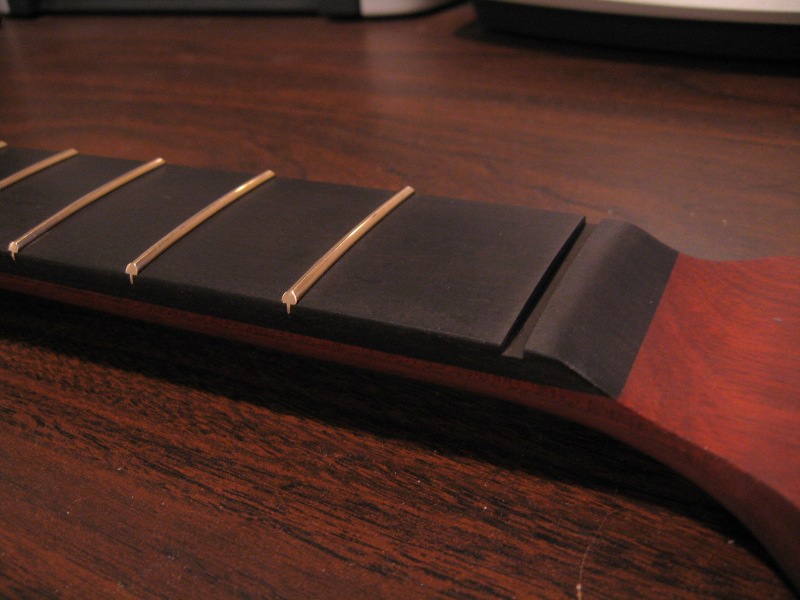

Ebony over Bloodwood Warhead w/ Gold Frets

More or less. I still have to wire it. I was waiting on a battery box, but that's here now so there's no real excuse. Still, here are a couple shots of it...
Thanks. Plays really nice, too. That Ebony over Bloodwood neck is super sweet. The only downside to the whole thing is it's surprisingly heavy, especially considering the body is chambered. It weighs 8.75 lbs. (just shy of 4 Kg), so it's like wearing a Les Paul.

No, not ridiculous. You're right; they're potted with epoxy or something like that, so they are kinda heavy. These are some of the old, original EMG-58s. Tough to find any data on them.
In this case, I think I picked up most of the weight in the neck. Ebony and Bloodwood are both pretty dense, plus it's got a dual truss rod and I used Schaller mini-lockers. It weighs exactly 2 pounds, while the Rosewood over Maple "Total Vintage" w/ Klusons I just put on a Jaguar only weighed a pound. That's a substantial adder.
You did a great job with the finish on that VIP.  The Warhead works quite well with the body shape, more than I would've expected really.
Thanks. It was more work than I'd wish on most people, but the results paid it back.
I'm a huge fan of the Warhead. and wish I'd have known earlier that you can get any Strat head re-cut that way. I'd have more of them. It gets rid of the superfluous flourishes of a normal Strat headstock without taking anything away from a good design. Everybody who's seen it in real life asks about it.
I'm starting to think I'm going to have to sell it. Everybody wants to play with it, and the first guy that puts a chip/scratch in it I'm going to have to kill. I'm too old for prison...
You oughta feel it. It's a lusty thing. I broke all the edges like Tonar does with his Maple necks, worked my magic on the frets, then burnished it overall. It's by far the best neck I've ever put my hand around, and I've handled a lotta necks. The only thing I've got that compares is an Ebony over Pau Ferro neck w/ SS frets. They're both real spoilers.
