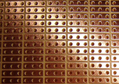

You can use a type of perf board called 'tri-pad", (as in comprised of a series interconnected three pad groups:
Cut it down to whatever size is convenient, position the pot over an unplated strip with the contacts on either side, and you then have open pads connected to the pot to solder your connections to.
