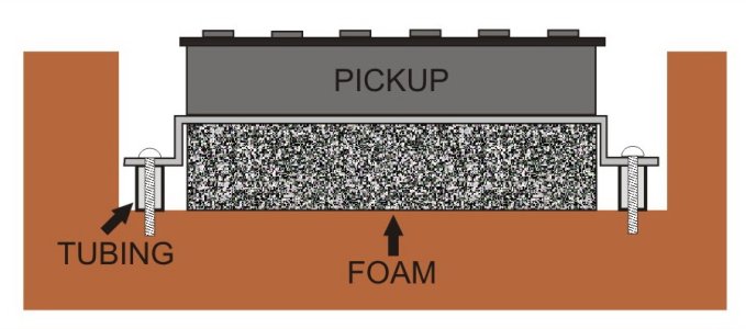

"Foam under pickup plate and screw through tubing?"
That would work; if you use the harder foam that typically comes as PU packaging you don't necessarily need the tubing; helps to drill pilot holes before installing screws.

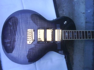

I think i'll end mounting my pickups like this version  :toothy12: :toothy12: :toothy12:
Well that's direct!
But use black tape for a darker sound, yellow tape for a brighter sound or two bits of tape for a stereo sound. :laughing7: :toothy10: :laughing7:
