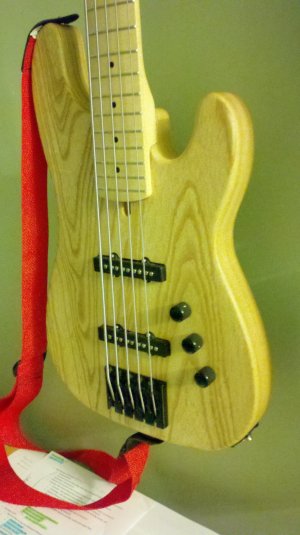

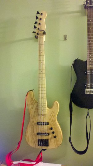

Delexe 5 New 51 Slab Swamp Ash with Maple Tele Neck.
Finished with Teak Oil and a Poly Wipe On
When I set out to buy a 5 string bass i pondered making a through neck from a Carvin blank. I wanted to make sure the low b was tight, and had read that a through neck would help with that but a bolt on could have a very tight low b. I read that stiffening rods in a bolt on would give a tight low b. When I saw a tele maple 5 string deluxe for $155 at warmoth used stiffening rods, I made my choice..
I also read that stringing the low b through the body would also increase the tension of the string and improve the. I Modified the bridge to allow for low b string to load through the body (others load through the bridge) for tigher tension to prevent having a flabby sounding low b.

Model Deluxe 5 51
Orientation Right handed
Core Wood Swamp Ash
Top/Rear Rout Rear Rout
D5 Pickups J-Bass (5 String Neck , 4")
D5 Pickups J-Bass (5 string Bridge, 4 1/8")
D5 Bridges Takeuchi T5 - String-Thru Body
Output Jack 7/8" (22.23mm) Side Jack Hole
Scale 34 inch
Headstock Tele Deluxe 5
Construction Bass
Orientation Right Handed
Shaft Wood Maple
Fingerboard Wood Maple
Nut Width 1 7/8"
Back Contour Asymmetric
Fretwire 6105
Tuner ream GB7 (14mm)
Fret Number 22
Radius Straight 10"
Inlays Black Face Dots
Nut Install GraphTech White TUSQ
Neck Finish No Finish
Scale 34 inch
2010 Fender V5 Jazz Bass Pickups [eBay/STRATosphere]
All Parts 5 String Bass Bridge
