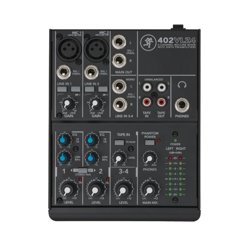

You might want to consider a Mackie 402VLZ4...
Gets you everything you asked for plus some things (see specs at link), and it's less than $100 for a high-quality part.

swarfrat said:
I'm just kinda shocked that ALL the standalone cheap preamps currently on the market are low voltage tube versions.
I'm not. I think the state of the art improved to the point where now many mixers include some pretty high-quality preamps with low noise, wide dynamic range and solid power, so the aftermarket just fell apart and what's left is mostly gimmicky.
Yeah, since most mixers and audio interfaces provide as good of a built-in preamp that you're going to get for a reasonable price, the market is for either higher end or "colored" preamps.
And they're not really tube preamps - they're actually SS preamps with a starved plate tube distortion stage added. If you can turn down (or defeat) the tube stage, you end up with a basic SS preamp.
