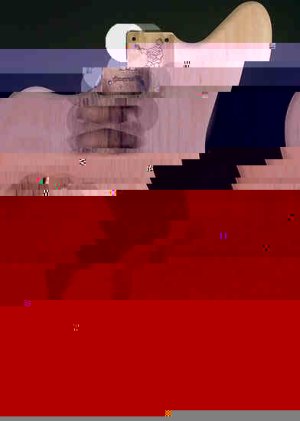

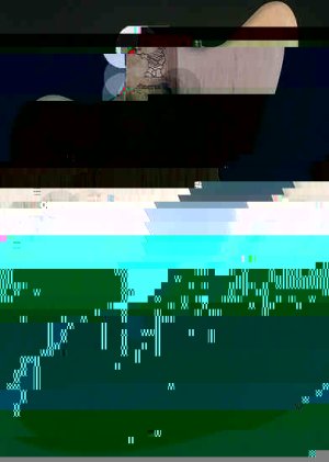

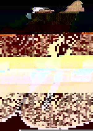

Thanks for being inspired by my monster. The custom routing for this guitar wasn't as hard to get done as you might think. Basically I asked for a tele route on a Jazzmaster body which wasn't a problem. The most difficult thing for them was to reposition the control cavity down the body so it would balance the look. As you can see from the pictures, this leaves more wood than normal on a Jazzmaster so weight is definitely a factor. I dont think you are going to get a hollow one so maybe think of something lighter with a padauk top perhaps? I love the piano bridge by the way. Eric was really helpful and patient with me when I dumped this on him and that's what inspires me. Talk to your rep and if possible give him some visuals. I'm sure you can work something out, hope this helps  Willy
