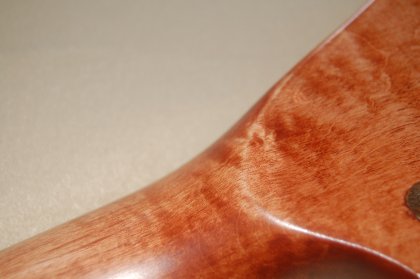

This is a maple neck from a cheap kit, stained (mahogany color) and finished with first a couple of coats of linseed oil, and then a number of coats of Tru-oil. For a darker color, ebony colored stain would work just as well.
