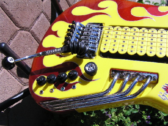

I seriously don't get all the Floyd bashing, I mean I have a whole room full of Floyds and have no problems at all. Ya there's some extra bits that go with it, but its still the same as any other floating bridge. I guess maybe I just took the time to learn and understand them... :dontknow:
Well, they're not the same as any other floating bridge are they? They're the only ones where you have to cut the ball off the string, the only one that needs a locking nut and so therefore fine tuners, the only ones that don't have a sensible way of setting intonation, the only ones that look like you've got a straight-6 hot rod engine mounted on the guitar body...

And speaking of hot rod engines on a guitar... :laughing7:
