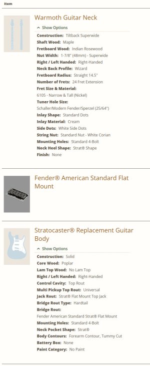

For instance, I'm trying to get close to a string spacing of 43mm at the nut and, if I'm comparing to a nylon classical, about 57mm at the bridge. I think I know which neck to order, but will I find an electrical guitar bridge that will make sense with the wide neck?
Here's what I think I'll need, please chime in :)
The "Vintage Spaced Strat Flat-Mount" bridge that Warmoth sells has 57mm spacing, the widest spaced electric bridge that I've seen. For that bridge you'd want the corosponding "vintage strat flat mount" bridge route. https://warmoth.com/sfm1
Most vintage spaced strat hardtail bridges are a hair less wide at 2-7/32"/76.4mm. If you could live with that and would like a "fancier" bridge there's options from Callaham and others https://www.callahamguitars.com/strat_bridge_hardtail_catalog.htm

The Vintage Strat Flat-mount on the Warmoth website lists 57mm/ 2-1/4"
